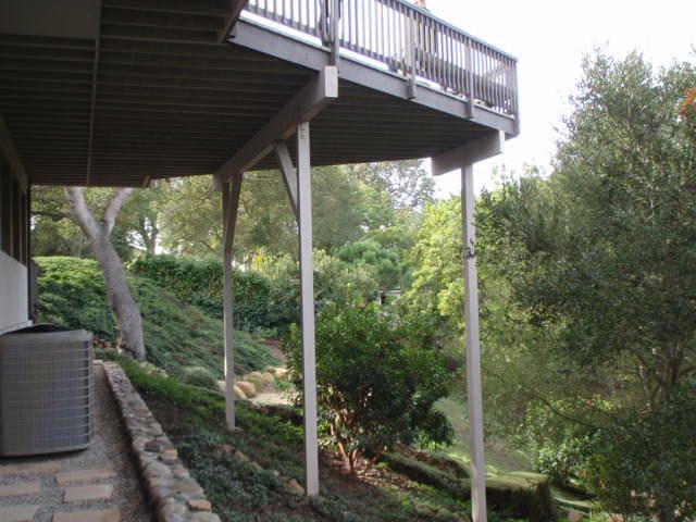

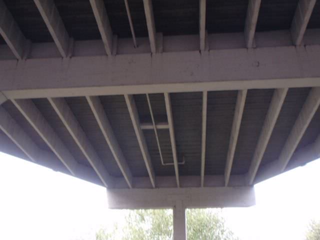

inspectorwill Posted December 5, 2012 Report Share Posted December 5, 2012 I don't like them because there always seems to be a headline story of collapses and because many that I come across are a unique design and just don't look right. Attached are pics of this deck about 20' off the ground on a hillside in earthquake country (California). Deck has been there a while but just looks like a moderate quake or maybe an overzealous woodpecker could bring it down. Have a looksie and I appreciate any comments. Click to Enlarge 65.48 KB Click to Enlarge 27.41 KB Quote Link to comment Share on other sites More sharing options...

Jim Katen Posted December 5, 2012 Report Share Posted December 5, 2012 I don't like them because there always seems to be a headline story of collapses and because many that I come across are a unique design and just don't look right. Attached are pics of this deck about 20' off the ground on a hillside in earthquake country (California). Deck has been there a while but just looks like a moderate quake or maybe an overzealous woodpecker could bring it down. Have a looksie and I appreciate any comments. The first thing that jumps out is the teeter-totter beam at the far outboard end. The second thing is the slenderness of the posts in their narrow dimension. Then, I see poor connections between the posts and the beams. I really don't like that Tee-shaped connector in the second picture. I also wonder about lateral support. When you stand at the end of the deck and sway back & forth, does the deck sway with you? Quote Link to comment Share on other sites More sharing options...

Jim Baird Posted December 5, 2012 Report Share Posted December 5, 2012 Looks like an installation by a minimalist sculptor. My brother had one of those teeter-posts where the contractor left out one to avoid standing it on top of a septic tank. Deck looks to me like it would sway in a breeze. Love the landscaping. Quote Link to comment Share on other sites More sharing options...
Marc Posted December 5, 2012 Report Share Posted December 5, 2012 There was a deck article in JLC a while back in which the author said that 100 Lbs per square foot of deck was not an unreasonable figure to use for deck design. Do a little measuring and multiply the SF by 100 then consider if the ledger and three spindly legs would be up to holding up that much weight beyond doubt. BTW, what's holding up that outside corner in the background? Marc Quote Link to comment Share on other sites More sharing options...
kurt Posted December 5, 2012 Report Share Posted December 5, 2012 I'd be canning that thing as a disaster in waiting. Just because it's still there isn't a testament to adequacy. Quote Link to comment Share on other sites More sharing options...

Mike Lamb Posted December 5, 2012 Report Share Posted December 5, 2012 I would feel better if those were single length joists but they look spliced at the beam which means the point will be subject to sway and scissoring IMO. Some creative A slanted columns at the point would go a long way in making it less scary. Quote Link to comment Share on other sites More sharing options...

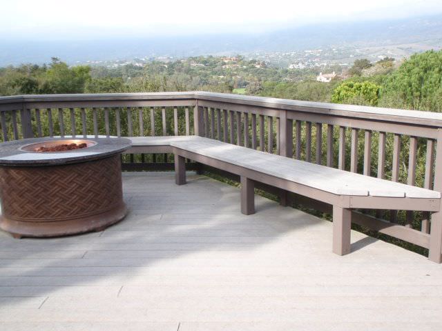

inspectorwill Posted December 6, 2012 Author Report Share Posted December 6, 2012 Thanks for all the input. Just re-affirmed the way I felt about it. This is one of those 2 million dollar properties that has undergone "extensive renovation" including the deck. They made it pretty up top with new composite surfacing and rails but left the original substandard structure supports. Oh and they included a nice bench against the guardrail at the highest point just so the kids can have a nice platform to plunge from. Pic attached. To answer Marc's question, the far corner is cantilevered off the house. Click to Enlarge 54.15 KB Quote Link to comment Share on other sites More sharing options...
