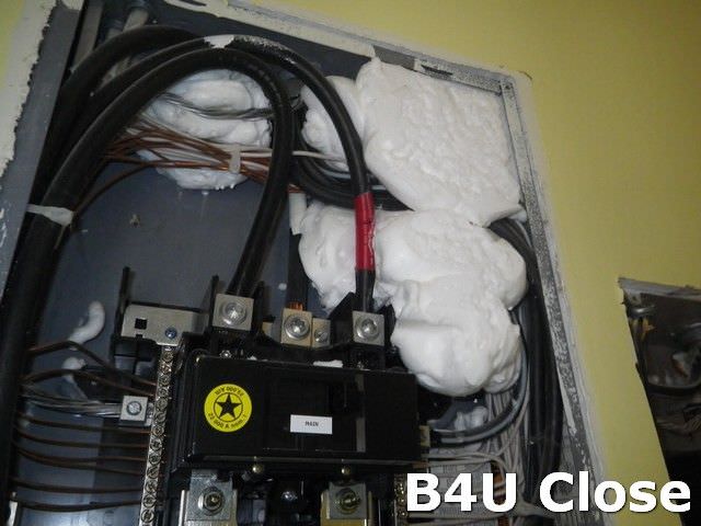

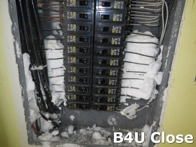

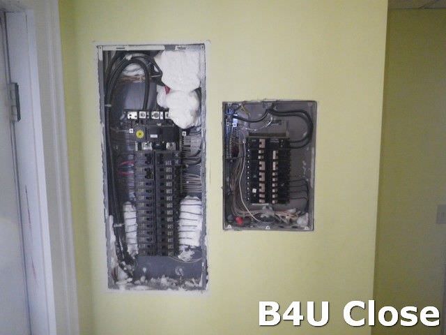

Erby Posted September 22, 2013 Report Share Posted September 22, 2013 Some things just make you wonder about how great "Great Stuff" really is. I think it's a problem. Do you? Click to Enlarge 41.8 KB Click to Enlarge 61.63 KB Click to Enlarge 52.28 KB Quote Link to comment Share on other sites More sharing options...
inspector57 Posted September 22, 2013 Report Share Posted September 22, 2013 Yes, it is a contaminant even if it is not flammable... but then what if it is flammable? Quote Link to comment Share on other sites More sharing options...
Marc Posted September 22, 2013 Report Share Posted September 22, 2013 Definitely an issue. It's dielectric properties aren't investigated, as far as I know, for an application involving direct contact with energized surfaces for the simple reason that it wasn't intended for such applications in the first place. My write-up would likely rhyme with that. Marc Quote Link to comment Share on other sites More sharing options...
John Kogel Posted September 22, 2013 Report Share Posted September 22, 2013 That is amazing. Somebody kept his finger on the trigger for a couple of minutes to do that. It is not a good thing, that's for sure.[] Quote Link to comment Share on other sites More sharing options...
kurt Posted September 23, 2013 Report Share Posted September 23, 2013 That warms my heart. Truly, a thing of beauty. Quote Link to comment Share on other sites More sharing options...
Erby Posted September 23, 2013 Author Report Share Posted September 23, 2013 Ah Kurt, you've noticed how very carefully they've scraped it off at the bottom of the panel to expose the hot wires to the breakers. VERY carefully done. Insert sarcasm emoticon here. Quote Link to comment Share on other sites More sharing options...
kurt Posted September 23, 2013 Report Share Posted September 23, 2013 Yes, craftsmanship at its finest. The guys that could do this sort of work are all dead now. Quote Link to comment Share on other sites More sharing options...
plummen Posted September 23, 2013 Report Share Posted September 23, 2013 Yes, craftsmanship at its finest. The guys that could do this sort of work are all dead now. Thank god![:-monkeyd Quote Link to comment Share on other sites More sharing options...
ghentjr Posted September 23, 2013 Report Share Posted September 23, 2013 The picture makes me think it is UFFI and not Great Stuff. Looks like it turns to powder based on the second pix. Quote Link to comment Share on other sites More sharing options...
Erby Posted September 23, 2013 Author Report Share Posted September 23, 2013 Good bet, John. It was white not the typical great stuff yellow and it was a few years old. In any case, it's a fine case of workmanship! Quote Link to comment Share on other sites More sharing options...
ghentjr Posted September 23, 2013 Report Share Posted September 23, 2013 I agree with the workmanship issue but wouldn't want to see you hung by mis-identifying it to your clients. Even though it has probably off-gassed because of its age, it is still a Formaldehyde based product. One older home I inspected had this installed and had a chunk of missing plaster in a closet and it managed to fill the upper shelf engulfing a bunch of hand bags stored on the shelf. Quote Link to comment Share on other sites More sharing options...
Les Posted September 23, 2013 Report Share Posted September 23, 2013 John likely is right. Does not look like Great Stuff. Quote Link to comment Share on other sites More sharing options...
kurt Posted September 23, 2013 Report Share Posted September 23, 2013 It is not Great Stuff, but I don't think it's UFFI either. UFFI that I see always has a very distinct yellow color. Also, it'd be a little powdery by now, and some chunks broken off. The panel looks too new to have been installed 35+ years ago. So, what the heck is it? Quote Link to comment Share on other sites More sharing options...
Tom Raymond Posted September 23, 2013 Report Share Posted September 23, 2013 Retro foam, Applegate R foam, or something similar. I know there is was at least one applicator in Kentucky. After two days of training with her crew I think it looks like her work. Last I heard she went bust. Quote Link to comment Share on other sites More sharing options...
rkenney Posted September 23, 2013 Report Share Posted September 23, 2013 So, what the heck is it? How about foam in place packaging? Quote Link to comment Share on other sites More sharing options...
Scottpat Posted September 23, 2013 Report Share Posted September 23, 2013 Looks like Icynene foam.... My SWAG is that the walls were foamed during construction, this is done after the electrical is roughed-in. That foam will find every crack or hole and we now see how well it expands and seals everything. Great find! Quote Link to comment Share on other sites More sharing options...
hausdok Posted September 23, 2013 Report Share Posted September 23, 2013 I'm with Scott, It's probably slow-cure icynene. You can shoot that into a wall cavity and it will take hours to fully expand and cure. ONE TEAM - ONE FIGHT!!! Mike Quote Link to comment Share on other sites More sharing options...
Carson2006 Posted September 23, 2013 Report Share Posted September 23, 2013 If you would like an NEC reference, it seems to violate Article 110.12 (B), Integrity of Electrical Equipment and Connections; in case you'd like a reference. Mr. C Quote Link to comment Share on other sites More sharing options...
Neal Lewis Posted September 23, 2013 Report Share Posted September 23, 2013 The picture makes me think it is UFFI and not Great Stuff. Looks like it turns to powder based on the second pix. When was the last time UFFI was used? And what is the age of the panel box? I'd say there is a thirty year difference, at least. Quote Link to comment Share on other sites More sharing options...
ghentjr Posted September 23, 2013 Report Share Posted September 23, 2013 http://www.carsondunlop.com/2011/12/ure ... nsulation/ Quote Link to comment Share on other sites More sharing options...
kurt Posted September 23, 2013 Report Share Posted September 23, 2013 Yeah, slow cure icynene. Quote Link to comment Share on other sites More sharing options...
Erby Posted September 23, 2013 Author Report Share Posted September 23, 2013 I agree with the workmanship issue but wouldn't want to see you hung by mis-identifying it to your clients. It's that looking out for each other that keeps us coming back here. The panel was installed about 15 years ago in a 97 year old house that had been rewired. Other than the foam, the panel had been fairly nicely done. I'd bet it wasn't the electrician that put it there. Report is long gone but I just told them: The foam sprayed inside the panel is a contaminant. I don't know if it's flammable or not but it should be removed. I'd bet it's not approved for contact with energized surfaces in an electrical panel. Quote Link to comment Share on other sites More sharing options...
Jim Katen Posted September 24, 2013 Report Share Posted September 24, 2013 If the foam worked its way onto any energized parts of the panel, or onto any connection points, I'd argue that the entire panel should be replaced. Quote Link to comment Share on other sites More sharing options...
kurt Posted September 24, 2013 Report Share Posted September 24, 2013 Replacement is the prudent call. Quote Link to comment Share on other sites More sharing options...
