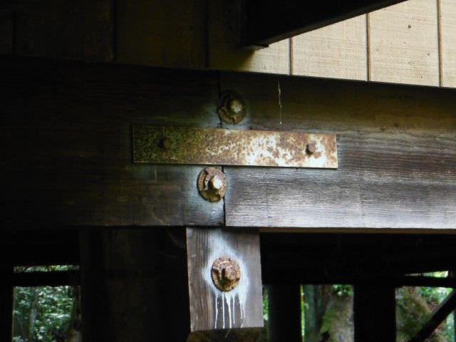

Denray Posted July 29, 2014 Report Share Posted July 29, 2014 Most of today's house had its beams bolted to the sides of posts. 1978 build. I suggested client get a hold of the engineering report. Whatcha all think about it? Click to Enlarge 50.07 KB Click to Enlarge 36.7 KB Click to Enlarge 42.5 KB Quote Link to comment Share on other sites More sharing options...

palmettoinspect Posted July 29, 2014 Report Share Posted July 29, 2014 Typically you would see the pilings notched and the beams resting inside the notch and then through bolted. Quote Link to comment Share on other sites More sharing options...

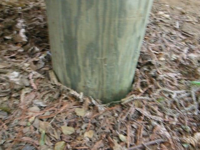

Denray Posted July 29, 2014 Author Report Share Posted July 29, 2014 These just seem to go down into the crete. Click to Enlarge 57.31 KB Some got dirt around them. Some are a bit rotten. Other than that it's a nice set up. Click to Enlarge 46.84 KB Click to Enlarge 66.17 KB Quote Link to comment Share on other sites More sharing options...
mjr6550 Posted July 30, 2014 Report Share Posted July 30, 2014 Without notching for the beams the load on the bolts will exceed the allowable load-but it will not fall down. You are correct to call this out. The bolts at the spliced beam are also too close to the end of the beam. Quote Link to comment Share on other sites More sharing options...
kurt Posted July 30, 2014 Report Share Posted July 30, 2014 Bury them in concrete and they rot. I'd want to see notches, steel support angles, or some similar iron/steel reinforcement at all those joints, in addition to more bracing. Quote Link to comment Share on other sites More sharing options...

Eric B Posted August 11, 2014 Report Share Posted August 11, 2014 My concern would certainly center on the rusting fasteners. Quote Link to comment Share on other sites More sharing options...
