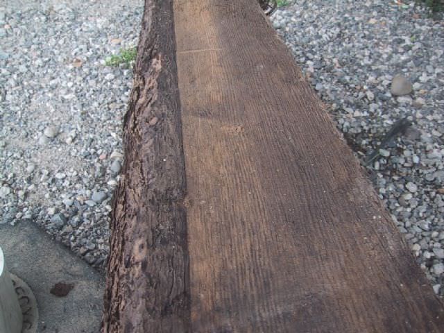

Jim Katen Posted November 3, 2014 Author Report Share Posted November 3, 2014 I've read about old construction methods of using hewn timbers for footings when they are to be below the water table and are likely to remain saturated. I can certainly believe it. But, in most cases, 1911 building footings around here are nowhere near deep enough for that. In our climate, the soil 6-8 feet down goes through wide swings in dampness and soil saturation. Stuff at or slightly below footing level tends to rot pretty readily. If it's deep enough and wet enough, though, I could see how it would work. I recently worked on a new construction project where the site had been filled in about 100 years ago. During excavation, they discovered all kinds of lumber buried down there - it seemed to be about 20 - 30 feet down. It was all in great shape; solid and hard as a rock. Pics of one chunk are attached. Click to Enlarge 102.05 KB Click to Enlarge 79.08 KB Quote Link to comment Share on other sites More sharing options...

kurt Posted November 3, 2014 Report Share Posted November 3, 2014 Old growth timber is highly decay resistant if it's kept wet. Green oak is used extensively for breakwaters and other erosion structures on the Great Lakes. I have green oak timbers that we installed >20 years ago still working fine. Quote Link to comment Share on other sites More sharing options...
gtblum Posted November 3, 2014 Report Share Posted November 3, 2014 Saturated wood does not rot? Marc They salvage old growth logs from ship wrecks. Big money. Quote Link to comment Share on other sites More sharing options...
kurt Posted November 3, 2014 Report Share Posted November 3, 2014 That's right. Folks are "mining" old timbers out of bays and estuaries where logging was big business >100 years ago. Logs that have been buried in muck for 120+ years are in perfect condition. It's also why one has to be very careful when pulling their old boat out of the water for repairs. When they dry out, they might fall apart. Quote Link to comment Share on other sites More sharing options...

mjr6550 Posted November 4, 2014 Report Share Posted November 4, 2014 In swamp areas, like Boston ans Washington, D.C. I believe they used timbers for foundations. Timbers, like wood pilings can last hundreds of years if they remain constantly wet. No oxygen is the key. If they get wet and dry than deterioration occurs. Quote Link to comment Share on other sites More sharing options...
