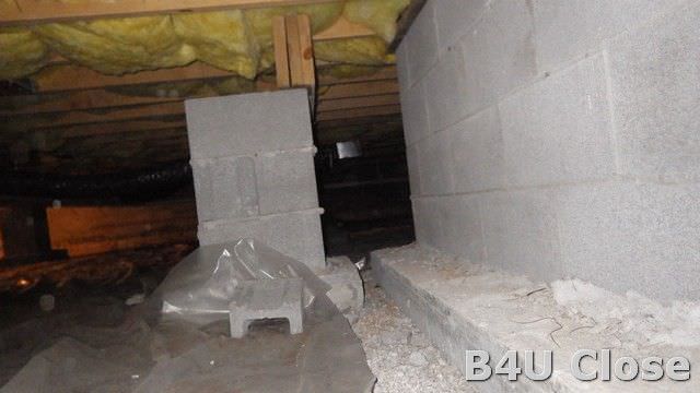

Erby Posted December 20, 2014 Report Share Posted December 20, 2014 I'm thinking this beam should have some lateral restraint. Your thoughts? Click to Enlarge 38.31 KB Click to Enlarge 35.86 KB Sure ain't entered very well either! Quote Link to comment Share on other sites More sharing options...
Marc Posted December 20, 2014 Report Share Posted December 20, 2014 Beam and pier centerlines should line up. Pier needs a cap which in this case is usually a 4 inch solid concrete cap with wood wedges between it and the beam. I don't see an inherent tendency of the beam to rotate. Marc Quote Link to comment Share on other sites More sharing options...

Eric B Posted December 20, 2014 Report Share Posted December 20, 2014 Why is it so close to what appears to be a bearing wall? Quote Link to comment Share on other sites More sharing options...
Jim Katen Posted December 20, 2014 Report Share Posted December 20, 2014 Why is it so close to what appears to be a bearing wall? I'm guessing that's where the bearing wall ends and the beam takes over. Quote Link to comment Share on other sites More sharing options...
John Kogel Posted December 21, 2014 Report Share Posted December 21, 2014 Why is it so close to what appears to be a bearing wall? I'm guessing that's where the bearing wall ends and the beam takes over. 12' joists were too short, 14's were too expensive. Who wants to drive an hour both ways for lumber? Pass me that jar by yer elbow and then let's get er dun. [] Quote Link to comment Share on other sites More sharing options...
Steven Hockstein Posted December 22, 2014 Report Share Posted December 22, 2014 Recently I was an expert on a case where the foundation wall settled and someone added some piers and a beam in the crawlspace to support the floor joists as cantilevers. How was the foundation? Maybe this is something similar. I would raise a big red flag to my clients. Quote Link to comment Share on other sites More sharing options...
Jim Baird Posted December 22, 2014 Report Share Posted December 22, 2014 Have seen this off centering often. Layout errors are often "exact" errors, off by one foot etc. OTOH, code calls for three inches bearing on masonry for wood structure. So this does "pass", no matter how sloppy it looks. Piers are supposed to be capped, like Marc said, or the top voids grouted to make a solid cap. Here lots of builders use treated pine for caps, and they appear to work OK. I see no problem with rotation. Quote Link to comment Share on other sites More sharing options...
Chad Fabry Posted December 22, 2014 Report Share Posted December 22, 2014 Have seen this off centering often. Layout errors are often "exact" errors, off by one foot etc. OTOH, code calls for three inches bearing on masonry for wood structure. So this does "pass", no matter how sloppy it looks. Piers are supposed to be capped, like Marc said, or the top voids grouted to make a solid cap. Here lots of builders use treated pine for caps, and they appear to work OK. I see no problem with rotation. That's funny. Capping the pier with pine to create bearing for pine. Quote Link to comment Share on other sites More sharing options...
