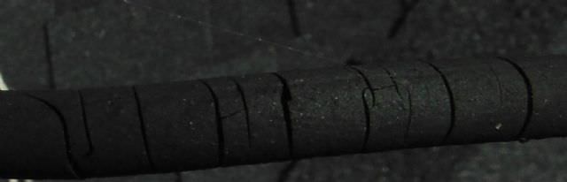

Denray Posted January 30, 2015 Report Share Posted January 30, 2015 Are these cracks in the service entrance in need of new insulation/replacement? If an ignant was touching the mast and this insulation would it arc thru and cook the ignant? Click to Enlarge 12.88 KB Quote Link to comment Share on other sites More sharing options...
Marc Posted January 30, 2015 Report Share Posted January 30, 2015 Are these cracks in the service drop in need of new insulation/replacement? If an ignant was touching the mast and this insulation would it arc thru and cook the ignant? No. Maybe just send him to the bathroom if the wire was wet. Old guys like you and I, it could kill...if wet. Marc Quote Link to comment Share on other sites More sharing options...
kurt Posted January 30, 2015 Report Share Posted January 30, 2015 Ignant = someone who knows better but does something really stupid anyway. If I saw those entrance conductors in that bad a shape, I'd probably put it in the report. The insulation is there for a reason; if it's compromised or failed, bad things can happen. Quote Link to comment Share on other sites More sharing options...
Chad Fabry Posted January 30, 2015 Report Share Posted January 30, 2015 I'd suggest replacement. To be honest though, on my house I'd give it two wraps with 3m #77 Electrical tape and paint to match. Quote Link to comment Share on other sites More sharing options...
Jim Katen Posted January 30, 2015 Report Share Posted January 30, 2015 It's repairable. Around here a few layers of good electrical tape will last for a decade or more. Quote Link to comment Share on other sites More sharing options...
kurt Posted January 30, 2015 Report Share Posted January 30, 2015 I agree. I'd be hitting it with 3M tape and it'd be fine. I'd never say that in a report though. It's just setting oneself up for some cavalier asshole to slam the stupid home inspector. If Mr. Cavalier wants to do it, cool. I don't know what it's like elsewhere, but a lot of the union guys just lay in waiting for HI's to say something they can contradict to make us look like dorks. Quote Link to comment Share on other sites More sharing options...

John Kogel Posted January 31, 2015 Report Share Posted January 31, 2015 Did someone (CF?) advocate taping a service conductor with a potential from the pole of about 3000 amps? [:-crazy] Don't do that. Spray some liquid tape on it maybe, but I would not touch it. Quote Link to comment Share on other sites More sharing options...

Jim Baird Posted February 2, 2015 Report Share Posted February 2, 2015 After all this I want to clarify what is in the OP picture. Is it what I call the service lateral before it connects with the service entrance at the mast head? That's what it looks like to me. In which case it's nobody's business but the POCO. What I see damaged all the time is the outside bundle wrap of the SEC, but that is past the meter base. Quote Link to comment Share on other sites More sharing options...
