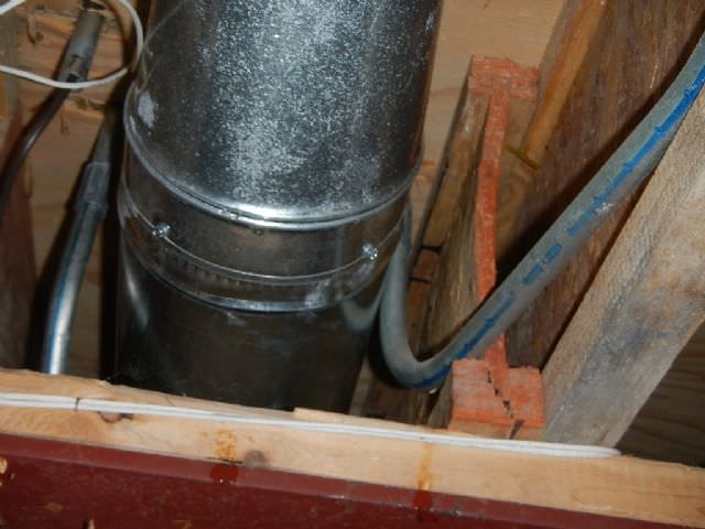

kurt Posted April 1, 2015 Report Share Posted April 1, 2015 Had one this AM lacking the blocks. Lottsa squashing going on. 2000 build date....heart of the lunacy. There's no way out of this, right? Any repair options at all? Click to Enlarge 51.8 KB Link to comment Share on other sites More sharing options...
Steven Hockstein Posted April 1, 2015 Report Share Posted April 1, 2015 jack slightly and then fill the web with plywood? not quite squash blocks but will add strength. Link to comment Share on other sites More sharing options...
Eric B Posted April 1, 2015 Report Share Posted April 1, 2015 jack slightly and then fill the web with plywood? not quite squash blocks but will add strength. But you would still have a damaged bottom chord. I expect that what a manufacturer might say and what could be done to reasonably "get by" would not be the same solution. Link to comment Share on other sites More sharing options...
Marc Posted April 1, 2015 Report Share Posted April 1, 2015 Had one this AM lacking the blocks. Lottsa squashing going on. 2000 build date....heart of the lunacy. There's no way out of this, right? Any repair options at all? I wouldn't get involved in that mess. Punt it. Marc Link to comment Share on other sites More sharing options...
Tom Raymond Posted April 1, 2015 Report Share Posted April 1, 2015 I could design and execute a suitable repair for that, but I am not the manufacturer or licensed to practice engineering. The house can be made whole, but not your client. I would start with the maker. Link to comment Share on other sites More sharing options...
Chad Fabry Posted April 1, 2015 Report Share Posted April 1, 2015 If it was mine, I'd move stuff out of the way and bang in blocks next to the joist. Link to comment Share on other sites More sharing options...
gtblum Posted April 1, 2015 Report Share Posted April 1, 2015 That's what you get when you build houses out of mulch and resin. Link to comment Share on other sites More sharing options...
kurt Posted April 1, 2015 Author Report Share Posted April 1, 2015 No way to bang in blocks without dismantling the house, and there's a lot of areas that aren't even accessible. I'm not getting involved. House isn't getting bought. I was asking mainly out of curiosity. I'd never seen one this bad before and wondered how one might go about "fixing" it. Link to comment Share on other sites More sharing options...
mjr6550 Posted April 2, 2015 Report Share Posted April 2, 2015 It depends upon how far the damage extends along the joist. Blocking can be retrofit, but access may make it difficult. Handling the crushing is easier than reinforcing the joists for shear. In a case like that I look for guidance from the manufacturer. They often will specify suitable repairs, or tell that that repairs are not possible. Link to comment Share on other sites More sharing options...
kurt Posted April 2, 2015 Author Report Share Posted April 2, 2015 This one is a mess. One side of the house is shifting south, the other north. Some are crushed, some are tilting, a couple a just plain mangled and coming apart. I was curious if anyone had ever seen or heard of a fix method. Link to comment Share on other sites More sharing options...
Rob Amaral Posted April 2, 2015 Report Share Posted April 2, 2015 Punt.. that's what I do... P.E. Link to comment Share on other sites More sharing options...
Erby Posted April 2, 2015 Report Share Posted April 2, 2015 Sometimes the right solution IS a bulldozer! Be curious to hear what the manufacturer would say about this one. Link to comment Share on other sites More sharing options...
Les Posted April 2, 2015 Report Share Posted April 2, 2015 I have never been involved with more than one or two joists. There may be a cure, but I would think it is really prohibitive. Never heard of "cure". Link to comment Share on other sites More sharing options...
kurt Posted April 2, 2015 Author Report Share Posted April 2, 2015 Yeah. I've only ever seen a couple at most, or an area that should have blocks that doesn't, but never full tilt squashing every which way. Squashed, tilted, some of the web was fracturing, subtle drywall cracking in lots of places that could easily be misread as lousy taping and finishing. After looking over the totality of this one, I don't think there's a fix either. And we fix some ****ed up pieces of shit. Link to comment Share on other sites More sharing options...
