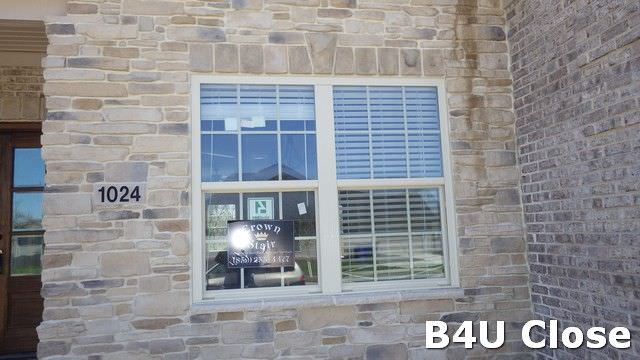

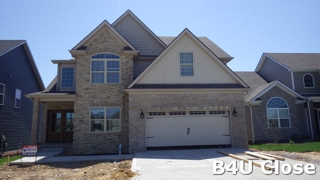

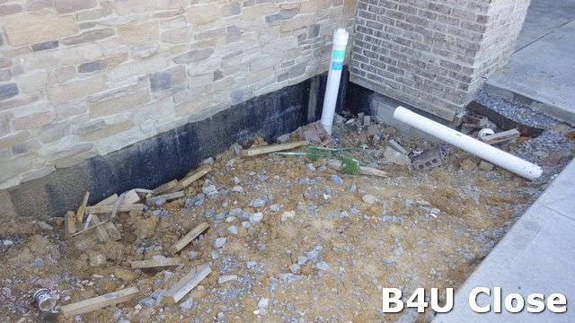

Erby Posted April 24, 2015 Report Share Posted April 24, 2015 Someone goofed the installation of the adhered stone masonry veneer. Yes, brand spanking, never been lived in, new house with water stained structural framing and water rotted subfloor at the stone veneer front. Anyone know of a way to fix it without ripping it off? Click to Enlarge 43.1 KB Click to Enlarge 56.76 KB Click to Enlarge 43.22 KB Click to Enlarge 54.16 KB Click to Enlarge 65.06 KB Click to Enlarge 39.88 KB Click to Enlarge 46 KB Click to Enlarge 46 KB Quote Link to comment Share on other sites More sharing options...

BADAIR Posted April 24, 2015 Report Share Posted April 24, 2015 not necessarily an Adhered Manufactured Stone Veneer (AMSV) installer issue if the contract was written for "to be installed by others" waterproofing, flashing and wrb...which is often seen the amsv contractor may only be responsible for the sacrificial wrb, lath, brown-scratch & asmv app regardless "latent defect" can't be fixed from the visible surface...remove, properly weather-air proof & restart with a good grasp of the manual & better supervision Quote Link to comment Share on other sites More sharing options...

StevenT Posted April 25, 2015 Report Share Posted April 25, 2015 MSV follows the same rules as Stucco. The primary point of failure is the missing kickout flashing. So whatever they do, if that is not corrected it will recur. A kickout flashing can be installed without ripping everything off. How is everything else? How many wrb(s) are there? Quote Link to comment Share on other sites More sharing options...
Erby Posted April 26, 2015 Author Report Share Posted April 26, 2015 I disagree Steven re the primary point of failure but certainly agree that the kickout flashing can be installed without ripping everything off. However, the worst of the leaking (were the subfloor is water damaged the most) is at the far side of the veneer, by the door. I doubt that the missing kickout flashing would have helped that far away. There should be two WRB but the way it's installed, you can't see behind it to determine what's going on back there. How would you determine how many WRB are present? Quote Link to comment Share on other sites More sharing options...

Erby Posted September 13, 2015 Author Report Share Posted September 13, 2015 Realized today when reading Kurt's stuff about kick out flashing that I never updated the results of this new construction inspection. Went back a month later for a reinspection. The stone installer said the original installation was by Kentucky Code as they don't follow the national code and apparently had never heard of the MVMA. The builders solution was this. Click to Enlarge 59.76 KB Not much else they had agreed to fix was fixed either. The buyer wanted to walk. The buyer's agent said they could find a builder that was a little more cooperative on fixes. He walked and a couple of months later found a much better built new construction house a block away (*with no AMSV). When I was by there a month or so ago, the house still had the stone and was still on the market. Go figure. Quote Link to comment Share on other sites More sharing options...
