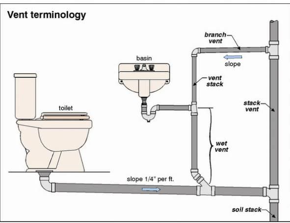

Denray Posted February 22, 2016 Report Share Posted February 22, 2016 Just doesn't look right? Click to Enlarge 44.44 KB Quote Link to comment Share on other sites More sharing options...
Jim Katen Posted February 23, 2016 Report Share Posted February 23, 2016 Sure. Google "horizontal wet vent." Quote Link to comment Share on other sites More sharing options...

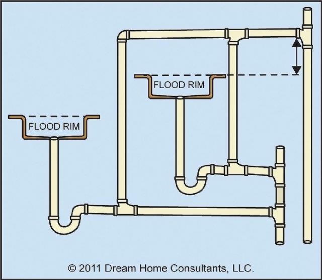

plummen Posted March 14, 2016 Report Share Posted March 14, 2016 Its not considered a vent untill its higher than the flood level of the highest fixture tied into it. Quote Link to comment Share on other sites More sharing options...
Jim Katen Posted March 15, 2016 Report Share Posted March 15, 2016 Its not considered a vent untill its higher than the flood level of the highest fixture tied into it. Don't you have horizontal wet vents in your area? 908.4 Bathroom Wet Venting. 908.4.1 Where permitted. Any combination of fixtures within one (1) or two (2) bathrooms located on the same floor level in dwellings and guest rooms shall be permitted to be vented by a wet vent. The wet vent shall be considered the vent for the fixtures and shall extend from the connection of the dry vent along the direction of the flow in the drain pipe to the most downstream fixture drain connection to the horizontal branch drain. Only the fixtures within the bathroom(s) shall connect to the wet vented horizontal branch drain. Any additional fixtures shall discharge downstream of the wet vent system and be conventionally vented. 908.4.2 Vent Connection. The dry vent connection to the wet vent shall be an individual vent or common vent for the lavatory, bidet, shower, or bathtub. 908.4.3 Size. The wet vent shall be sized based on the fixture unit discharge into the wet vent. The wet vent shall be a minimum size of 2 inches for 4 dfu or less, and 3 inches for more than 4 dfu. Quote Link to comment Share on other sites More sharing options...
plummen Posted March 15, 2016 Report Share Posted March 15, 2016 Click to Enlarge 40.77 KB Works the same every place Ive ever done plumbing work anyway. Of course around here we cant lay a san tee on its back the way they show in the picture. And yes we can wet vent a toilet through a sink,thats about it though. Quote Link to comment Share on other sites More sharing options...
Bill Kibbel Posted March 15, 2016 Report Share Posted March 15, 2016 What is the code for "around here"? Sani-tees can't be on their side for drainage. What's the prohibition for using them on their side for venting? How do you vent a toilet through a sink? Quote Link to comment Share on other sites More sharing options...
Les Posted March 15, 2016 Report Share Posted March 15, 2016 What is the code for "around here"? Sani-tees can't be on their side for drainage. What's the prohibition for using them on their side for venting? How do you vent a toilet through a sink? Bill, good questions. Thought it might just be me today. Quote Link to comment Share on other sites More sharing options...
plummen Posted March 16, 2016 Report Share Posted March 16, 2016 What is the code for "around here"? Sani-tees can't be on their side for drainage. What's the prohibition for using them on their side for venting? How do you vent a toilet through a sink? you wet vent a toilet just like this. City of omaha wont allow san tees to be used on side or back period,they want wyes used. Click to Enlarge 27.82 KB Quote Link to comment Share on other sites More sharing options...
