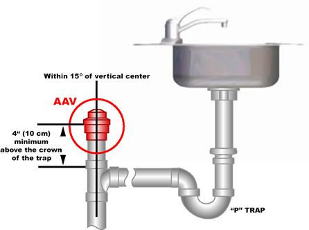

Mike Lamb Posted July 1, 2018 Report Share Posted July 1, 2018 Single bowl sink. Install an Air Admittance Valve - AAV (aka Studor vent). Water may be getting sucked out of the P-trap every time you drain the sink, or other drains are using the sink drain for venting. Is roof vent clogged? Quote Link to comment Share on other sites More sharing options...

DieHard DIYer Posted February 8, 2020 Report Share Posted February 8, 2020 (edited) Having issues with smell coming from under counter vented sink drain. Relatively new construction and home built on concrete slab. I installed (diehard DIYer here) the drainage for a doubl;e bowl sink with both sinks connecting to a p trap in the middle. The p trap is connected to the 3 inch main drain via a sanitary T (3 " w reduced to 1 & 1/2 ). Main drain fitted with under sink AAV vent approximately 5 inches above where p trap is connected. Main drain is connected under the slab to the vent stack going up the interior wall and through the roof at a distance of approximately 10 to 12 feet from the sink Most appreciative for any suggestions as to why the smell. Drains operate properly btw Thanks Edited February 8, 2020 by DieHard DIYer new posting rather than response Quote Link to comment Share on other sites More sharing options...
