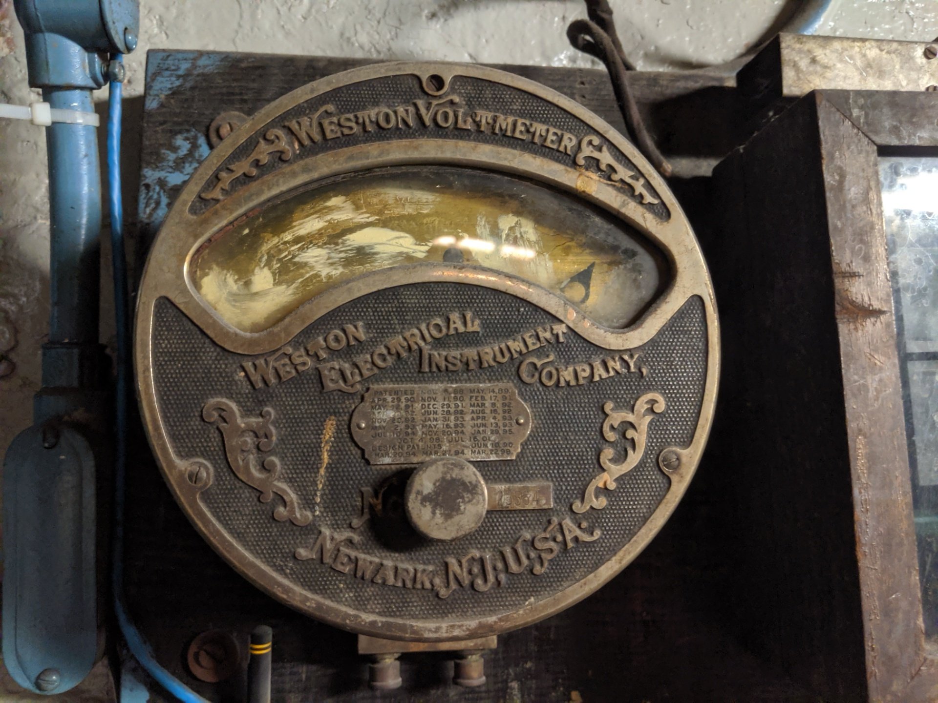

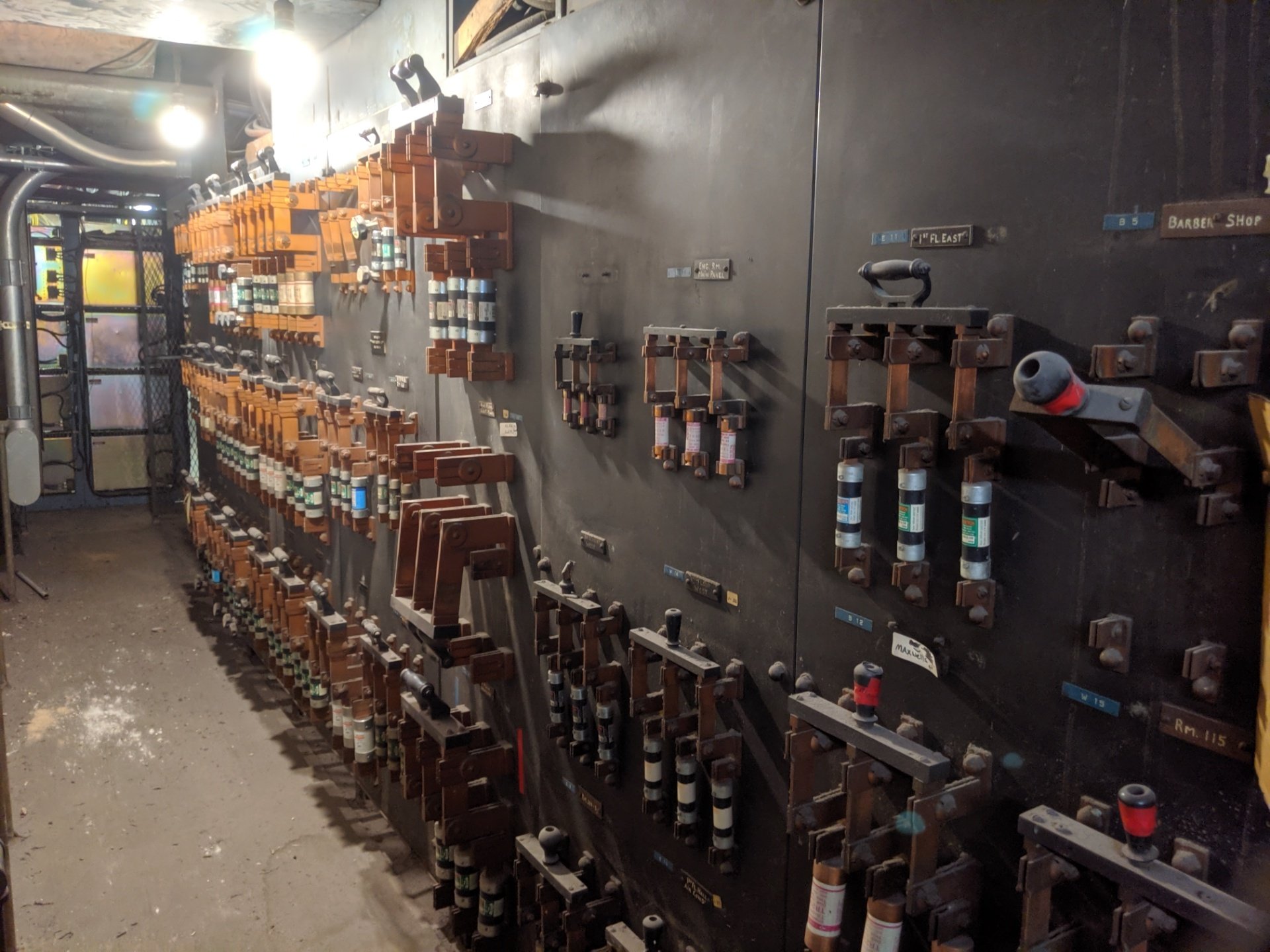

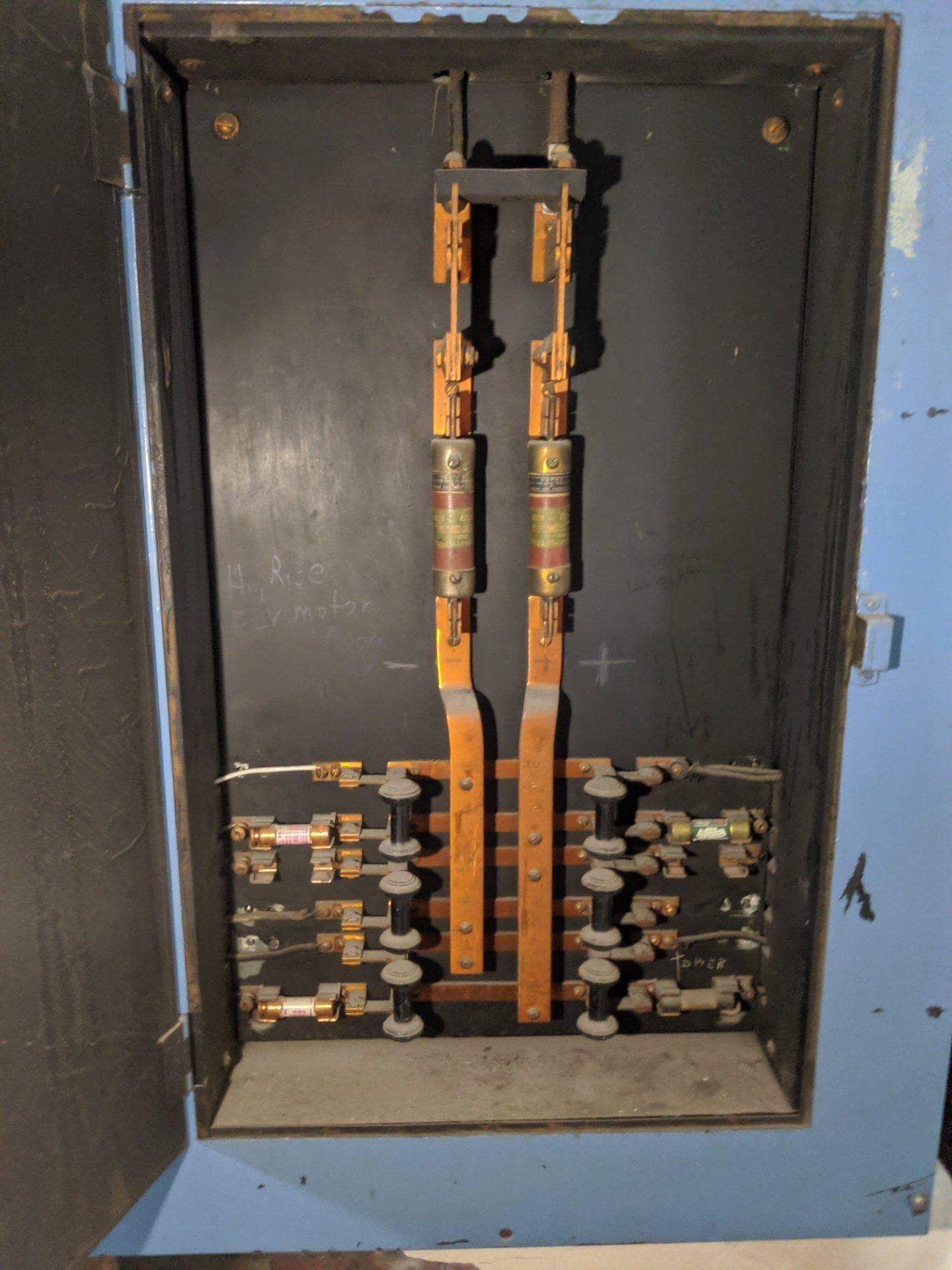

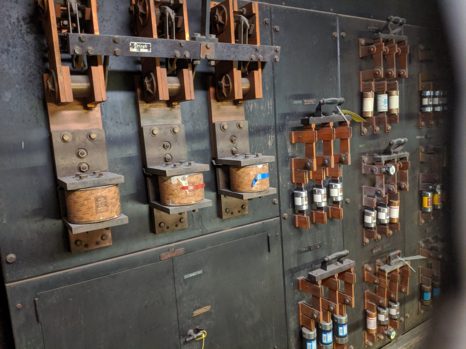

MPdesign Posted November 5, 2019 Report Share Posted November 5, 2019 All of these are hot and in-use - except for the Voltmeter. Quote Link to comment Share on other sites More sharing options...
Chad Fabry Posted November 5, 2019 Report Share Posted November 5, 2019 That's really cool. A little nerve wracking, but cool. Quote Link to comment Share on other sites More sharing options...
Marc Posted November 5, 2019 Report Share Posted November 5, 2019 480 volt nominal? Quote Link to comment Share on other sites More sharing options...
MPdesign Posted November 5, 2019 Author Report Share Posted November 5, 2019 120/208 3 phase The more that I think about it, this is as well made - most likely much better - than anything today. It is just missing a layer of grounded metal for safety. Quote Link to comment Share on other sites More sharing options...
Jim Katen Posted November 6, 2019 Report Share Posted November 6, 2019 It'll all work fine till the fuse holders loose their "spring" and you start to get heating at the connections, which causes the metal to get even more loose. The thing I love about equipment like that is the smell. There's always this great smell in those places. Quote Link to comment Share on other sites More sharing options...
