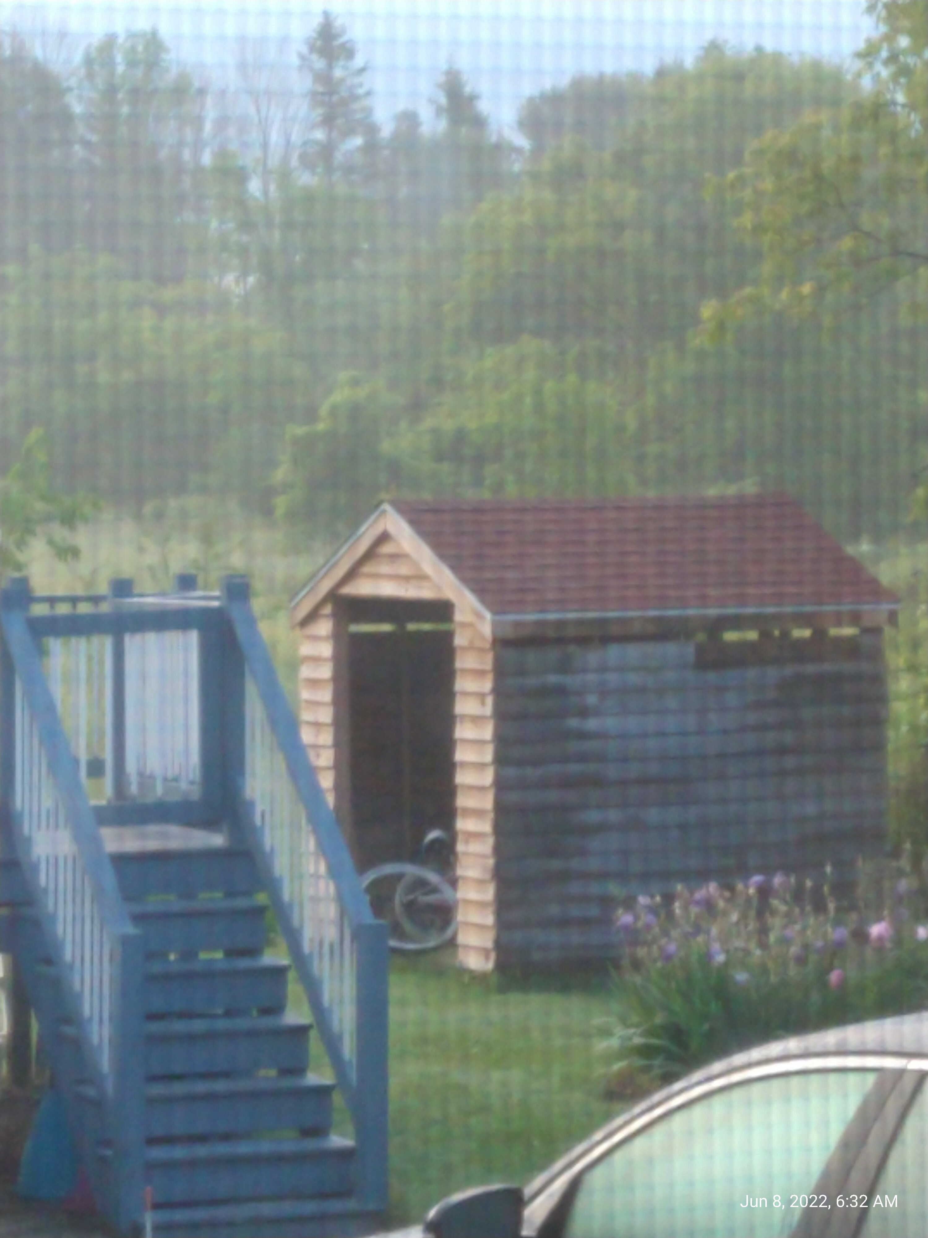

Tom Raymond Posted June 8, 2022 Report Share Posted June 8, 2022 I built one with my daughter over lockdown. It's 8x8 because someone tossed 2 sheets of pressure treated plywood on the scrap pile of a house I was building and I brought them home. The platform is a ridiculously overbuilt pallet for 18' azek beadboard split in half, then married back together with PT 2x4s through them. 6' sidewalls and a 6/12 roof make it 8' tall. A ridge beam eliminates wall ties so I can stand up in it. I kicked the end rafters to the outside of the walls and tied the tails the same, sub-fascia and soffit in one go. Walls and rafters are new 2x4s. Walls are angle braced without sheathing, roof deck is OSB leftover from pallet racking I sold years ago. Shingles are leftovers from the house. I had to buy a bundle of hip and ridge. Siding and trim is all dog ear treated fence pickets. Siding is lapped and face nailed to capture both planks. Corners will overlap siding and tuck behind fascias. It's not finished because boards were out of stock for almost a year, and of course, I ran out. The doors are roughed in for a pair of 32" slabs. If I find something I like they'll go in as is. If not, they'll be cambered so the trim doesn't look nippy where it meets the fascia, and be simple tongue and groove pine, maybe with little windows if I have the ambition. It's on this year's to do list, but so are about a million other things. 1 Quote Link to comment Share on other sites More sharing options...

John Dirks Jr Posted June 21, 2022 Author Report Share Posted June 21, 2022 It's starting to look like something. I have no plan really. I'm just making it up piece by piece as I go along. Kinda like we did when we were kids making forts out of stuff from the scrap pile. Although, I'm not pulling nails out of old lumber and hammering them straight on the pavement for reuse. Everything is screwed together. That lets me take it back apart when an idea turns out bad. Quote Link to comment Share on other sites More sharing options...

John Dirks Jr Posted June 21, 2022 Author Report Share Posted June 21, 2022 Cedar for all the cladding, all structure framing is pressure treated. Brick floor and galvanized roof. It will be tight enough to keep mice out unless the chew their way in. Quote Link to comment Share on other sites More sharing options...
