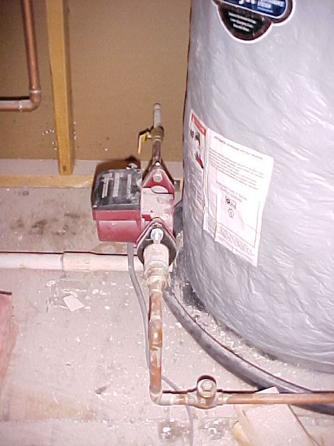

BADAIR Posted April 9, 2006 Report Share Posted April 9, 2006 Anyone know who's this is and what it does? I found this electric supplied valve on what appears to be a segregated water supply with a hose bibb termination located in the attic next to the water heater. Of course I took notes, name, model #...and left them between first, second inspection, and home, can't remember the name except I think it ended with 'man. Download Attachment: mysteryvalve.JPG 72.95 KB Download Attachment: mysteryvalve2.JPG 72.27 KB Thanks in advance for any help. Link to comment Share on other sites More sharing options...
Steven Hockstein Posted April 9, 2006 Report Share Posted April 9, 2006 Is the water heater being used to provide baseboard heat or radiant heat in a floor somewhere? Link to comment Share on other sites More sharing options...
StevenT Posted April 9, 2006 Report Share Posted April 9, 2006 Valve...or Pump? I see the cold feed and hot output on top of the tank, is the horizontal line in the backgroung a return of the hot water line back to the heater? Is the hose bib teed into where the drain on the heater would normally be? Does that line get hot when the heater is turned on. What is controlling the pump? I've done a few jobs, where it mattered that there be little or no delay of delivery of hot water at the fixture. The hot water line was a continuous loop back to the heater with a pump, and sensor on the return of the loop. When the sensor sensed a drop in the temp in the line, it would turn on the pump and circulate hot water throughout the line, Could this be that? Whatever it is, I don't find the 2x4's supporting the pump thrilling! Link to comment Share on other sites More sharing options...
mgbinspect Posted April 9, 2006 Report Share Posted April 9, 2006 I believe the Sevens are on the right track. It's difficult to tell from those photos, but it resembles a circulation pump as you would see on a hot water heating system such as a Aqua-Therm system. But, I've not seen such a system use an electric water heater. I have also seen pumps on water heaters of very large houses just to boost pressure or move hot water along. Could it be for hot water to a master bathroom with a jetted tub at the opposite end of the house? I've seen that before too. Just not enough info to be of much help. Link to comment Share on other sites More sharing options...
hausdok Posted April 9, 2006 Report Share Posted April 9, 2006 From that angle it's hard to tell, but it kind of looks like a Grundfos circulator. It's got the right color too. If so, it's probably supplying water to a radiant heating panel someplace - wall of a bathroom or floor of a foyer - or to a fixture far off somewhere else in the house where they wanted to get hot water quickly. ONE TEAM - ONE FIGHT!!! Mike Link to comment Share on other sites More sharing options...
Jim Katen Posted April 9, 2006 Report Share Posted April 9, 2006 Like the others said, it's just a circulating pump. It moves hot water in a big circle around the house so that no one will have to wait for hot water when they turn on the taps. I see 'em every week. I figured everyone saw them as often. - Jim Katen, Oregon Link to comment Share on other sites More sharing options...

BADAIR Posted April 10, 2006 Author Report Share Posted April 10, 2006 Thanks to all for the links and other info. The circulation pump sounds like the ticket for a 3-story condo. This is not a Grundfos circulator. I'm sure of that. Even during a senior moment I'd remember that name once seen again. I'll be going back if the clients don't back out for other reasons and will get the mfg. ID this time I'll put it in my money clip where I wont loose it before I can do the research. There's plenty of room in there I'm married. I did call out the unsecured pipe on unsecured 2x4 blocking. They ran all of the plumbing and the gas lines in the same manner, lazy. What is controlling the pump? Good question and I wont know without mfg. specs. 2Bcontinued...or it's on to a new property for these folks. They are not happy campers. Neither of their current vehicles can enter the parking garage. Approach is down a single lane alley hard left over a speed hump, under a 6’9†Link to comment Share on other sites More sharing options...
RobC Posted April 10, 2006 Report Share Posted April 10, 2006 You might also want to mention that without insulation, efficiencey will be reduced and the pipe could act as a radiant heating system. That is of course, assuming the circulator is intended for domestic hot water and not hooked up to a remote radiator or convector. Link to comment Share on other sites More sharing options...
Jim Katen Posted April 10, 2006 Report Share Posted April 10, 2006 Originally posted by RobC You might also want to mention that without insulation, efficiencey will be reduced and the pipe could act as a radiant heating system. That is of course, assuming the circulator is intended for domestic hot water and not hooked up to a remote radiator or convector. That's an important point. Also, if the pump is set to run 24/7, the constant circulation is going to scour the interior of the pipes, particularly at 90-degree ells. This will shorten the life of the pipes. If it isn't already on a timer, I'd add one. I'm curious to know if there's a timer under the top cover similar to the one in RobC's picture. - Jim Katen, Oregon Link to comment Share on other sites More sharing options...
