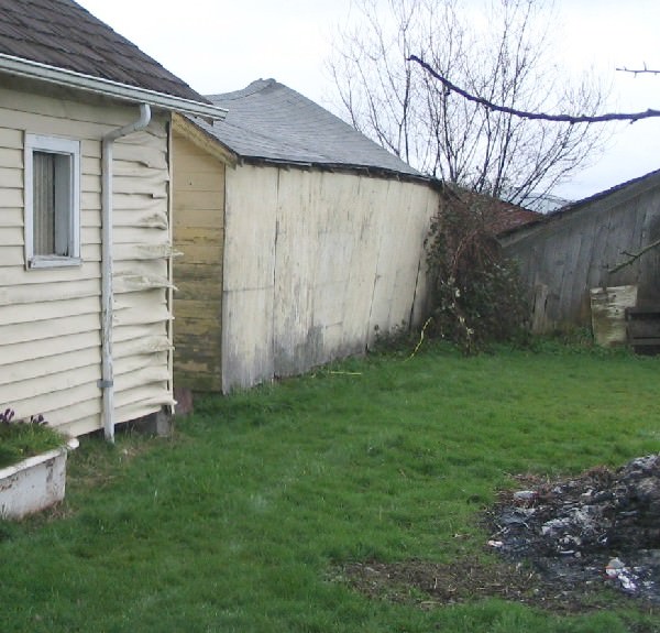

Richard Moore Posted March 7, 2007 Report Share Posted March 7, 2007 Me neither. I do have a nice photo of what happens if you burn your trash too close to the siding. Download Attachment: 050212H009.jpg 109.11 KB One of those "Duh!" moments. Quote Link to comment Share on other sites More sharing options...

hausdok Posted March 7, 2007 Report Share Posted March 7, 2007 Hi, I've seen it here Randy. In fact, I had it on a home in Issaquah within the past two weeks. The house in question had a little bumpout that was added at the back center of the house to form the dinette. It projects from the house with the walls of the bumpout oriented 45° to the back plane of the house and has windows on both sides. The back of the house faces dead south. The bottom 3ft. of siding at both the southeast and southwest corner is melted and deformed for about six feet from the outside corners. It clearly isn't caused by a barbecue grill and when you examine the houses at either side, which don't have the bumpout, they are fine. The following week, in another part of that development, when we did a house that had the exact same configuration and also was oriented south, the same thing, on a lesser scale, had occurred. The sun strikes those windows on the east side of the bumpout at a downward angle in the morning and is reflected onto the bottom of the siding at the southeast corner. In the afternoon, it strikes the windows on the west side and is reflected down onto the lower-west corner. There's nothing fancy about those windows. They were cheap Alping-brand spec-grade vinyl units and I didn't see any obvious concave deformation. Months ago, in a similar thread on the forum I moderate over at JLC, some contractors posted pictures of similar damage. One of these, was a builder here in Washington State. So far, in every instance that I've seen this, or have seen photos of it, the siding was a sort of light to medium gray color. Martin, I'd previously told you that it was tan, but after going outside and looking at some siding of the same color, it's without-a-doubt gray in color. ONE TEAM - ONE FIGHT!!! Mike Quote Link to comment Share on other sites More sharing options...

hausdok Posted March 10, 2007 Report Share Posted March 10, 2007 Awnings, trellis', pergolas, plantings - Anything to alter the concentration of sunlight on the windows, so what's reflected isn't so concentrated on the siding. OT - OF!!! M. Quote Link to comment Share on other sites More sharing options...
