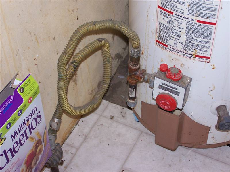

Mark P Posted June 8, 2007 Report Share Posted June 8, 2007 I do not see this type of old flexible gas line too often. What is it made of (named)? And I believe I've read it has a history of problems and should be replaced. Is that correct? Thanks mark Download Attachment: 1.jpg 84.03 KB Quote Link to comment Share on other sites More sharing options...
hausdok Posted June 8, 2007 Report Share Posted June 8, 2007 Hi, It's a brass line. They crack and they were all recalled back in 1997. Go to www.recalls.gov and search by product and you'll find it. ONE TEAM - ONE FIGHT!!! Mike Quote Link to comment Share on other sites More sharing options...
Les Posted June 8, 2007 Report Share Posted June 8, 2007 iiiiiiiiiiiiiiiiiiii We always write as immediate replacement of any brass gas line. There are millions out there and nearly all are bad. They will have a date on them; either on incoming fitting or on a ring around tube. The photo has an alum gas valve that I would recommend replacement of. Bonnie will love that sentence! Quote Link to comment Share on other sites More sharing options...
chicago Posted June 8, 2007 Report Share Posted June 8, 2007 They are very dangerous and 1997 sounds about right as I was working for sears at the time. They would snap off and leak just for the crime of moving an appliance to get at the shut off valve. Most of the time when you see these you will also have a frozen shutoff at the same location ,but thats another can of worms. Quote Link to comment Share on other sites More sharing options...

kurt Posted June 8, 2007 Report Share Posted June 8, 2007 Don't listen to Fabry. Don't trust rubber necked individuals. Same w/rubber asses; don't trust 'em. A brass line was the cause of the catastrophic explosion on the South side a couple years ago; an entire solid masonry bungalow was leveled to rubble. Quote Link to comment Share on other sites More sharing options...
Bill Kibbel Posted June 9, 2007 Report Share Posted June 9, 2007 Below is copied from this earlier thread on this topic: www.inspectorsjournal.com/forum/topic.asp?TOPIC_ID=3682 "Bad connector, uncoated brass: OK connectors: I really need to clean out my hard drive". Quote Link to comment Share on other sites More sharing options...
