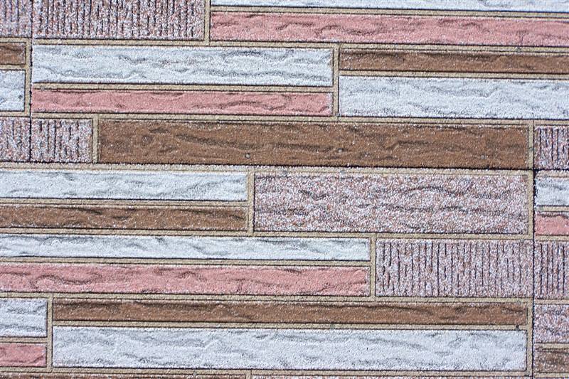

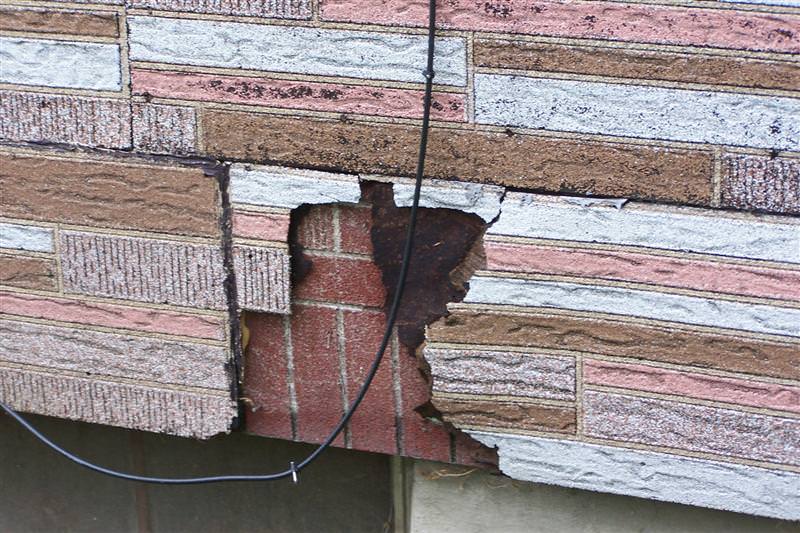

Mark P Posted June 11, 2007 Report Share Posted June 11, 2007 Appears to be an asphalt based product similar to asphalt shingles. Does any one know what it is and have a name for it. You can see there was another layer that looks like brick under the top layer, but seems to be the same stuff. Download Attachment: 1.jpg 100.57 KB Download Attachment: 2.jpg 149.35 KB Download Attachment: 3.jpg 128.36 KB Quote Link to comment Share on other sites More sharing options...
Bill Kibbel Posted June 11, 2007 Report Share Posted June 11, 2007 Asphalt siding. Some refer to it by its original brand names such as Inselbrick®, Inselstone® or Inselwood®. It's similar to asphalt roofing shingles, but backed with the old style Celotex. Available from the mid 1930s to about 1960. Quote Link to comment Share on other sites More sharing options...
kurt Posted June 11, 2007 Report Share Posted June 11, 2007 It's all over Chicago. I forget the brand name, but it's an asphalt impregnated celotex board. Quote Link to comment Share on other sites More sharing options...
Les Posted June 11, 2007 Report Share Posted June 11, 2007 Same as above, except the actual name around Mich was Insulbrick and Insulstone. Made by celotex and Jim Walters Co. It carried a UL rating for fire suppression and had an R value of 1.3. Bridged lap siding very nicely, quick to install and stopped the drafts. Bugs don't like it. Some even had asbestos impregnated in the fiber board. Quote Link to comment Share on other sites More sharing options...

mthomas1 Posted June 11, 2007 Report Share Posted June 11, 2007 One thing about Insulbrick, each panel (about 18x36") is usually held on with 4 #6 nails, so it comes off with little damage to the underlying siding. Quote Link to comment Share on other sites More sharing options...
Jim Katen Posted June 11, 2007 Report Share Posted June 11, 2007 Originally posted by Les . . . Bugs don't like it. . . They don't like the product itself, but they appreciate the shelter it provides. In my area, there are always carpenter ants under this stuff. - Jim Katen, Oregon Quote Link to comment Share on other sites More sharing options...
