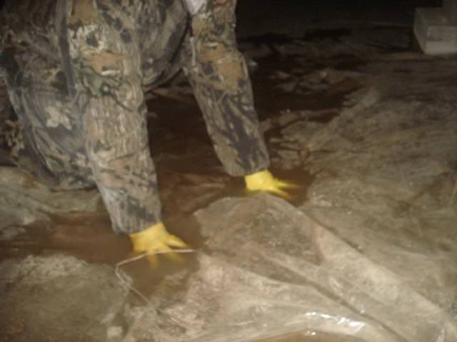

Erby Posted March 29, 2008 Report Share Posted March 29, 2008 Had a floater just a couple of weeks ago. Got about five feet in and realized it wasn't just wet and muddy by the entrance. Tossed a couple of rocks. Just like they were landing on the water bed, with the ripples and all. Declined to go any further until the water was gone. Image Insert: 37.23 KB Link to comment Share on other sites More sharing options...

Brandon Whitmore Posted March 29, 2008 Report Share Posted March 29, 2008 Hey Erby, I can see your hands, but where the heck is the rest of you body[:-magnify Link to comment Share on other sites More sharing options...
hausdok Posted March 29, 2008 Report Share Posted March 29, 2008 He's not allowed to show it. We've got a prohibition against posting obscene photos here. [] OT - OF!!! M. Link to comment Share on other sites More sharing options...
Erby Posted March 30, 2008 Report Share Posted March 30, 2008 That timed photo thing on the Sony Cybershot is a great tool. But alas, as Mike said! Link to comment Share on other sites More sharing options...
