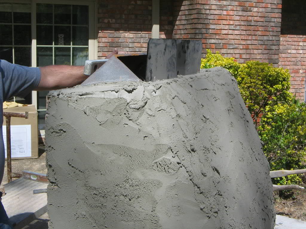

charlieb Posted October 12, 2008 Report Share Posted October 12, 2008 Download Attachment: Masonary 020.jpg 133.74 KB Download Attachment: Masonary 021.jpg 171.25 KB Best photos I've got. What bill said or a hammer drill. It should pop free of the mortar Quote Link to comment Share on other sites More sharing options...
