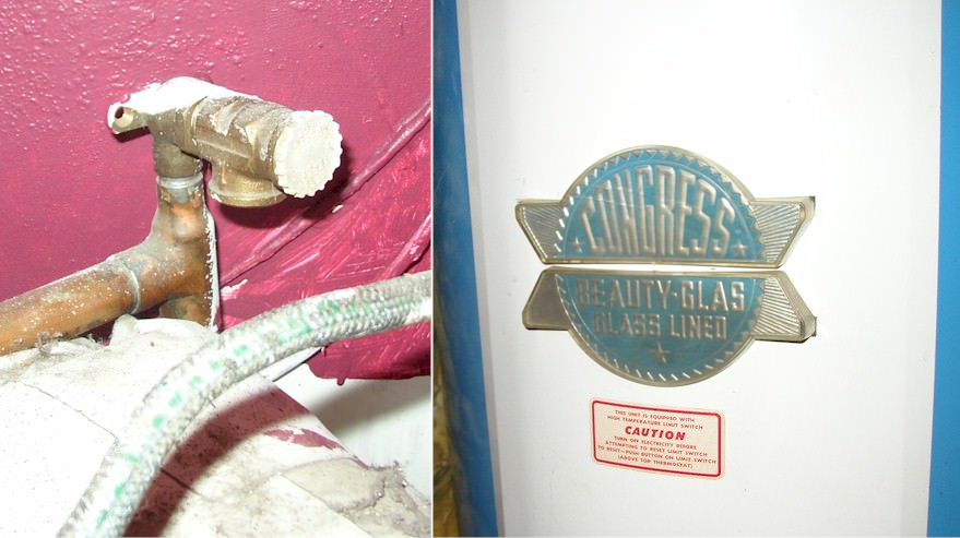

Richard Moore Posted November 18, 2008 Report Share Posted November 18, 2008 I saw one of these in 2003, on a Congress Beauty-Glas water heater. I remember posting the pictures back then (at IN I think). Never did figure out the exact age of the water heater, but the general consensus seemed to be '60s or early '70s. In other words...OLD!!! Image Insert: 100.54 KB I suspect that Jeremy's client also needs a new water heater. Quote Link to comment Share on other sites More sharing options...
Jeremy Posted November 18, 2008 Author Report Share Posted November 18, 2008 I suspect that Jeremy's client also needs a new water heater. You suspect correctly, and they were certainly informed of that. It is my own curiosity I am trying to solve at this point. Mike, you right, that is not a reducer. The TPR itself has 3/4 inlet and 1/2 outlet and so as far as IRC goes, it meets the requirements. ...but I still like TPRs with 3/4 all the way through... Do you concur? I'm glad the heater is toast! Quote Link to comment Share on other sites More sharing options...

Richard Moore Posted November 18, 2008 Report Share Posted November 18, 2008 Hi again Jeremy, I just took a look at the old report to refresh my memory. The home was built in 1965 and so it seemed very likely that it was the original heater. I don't know when (or why) they started or stopped making "glas" lined water heaters, but as your label has the same Retro look as the Congress, I'd guess it's from the same period. Aside from the funky TPR, mine was still working and showed no signs of leaks. Yours? Quote Link to comment Share on other sites More sharing options...
