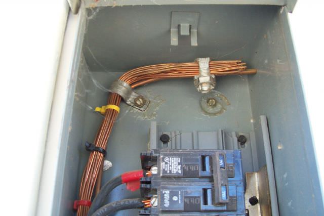

tbird Posted April 8, 2009 Report Share Posted April 8, 2009 Is this correct? How can all these wires be properly grounded? Code reference? This is the first time I have seen this. Click to Enlarge 34.47 KB Also on the same job. Does anybody have a shingle stretcher? Click to Enlarge 76.09 KB Thank you for your help! Quote Link to comment Share on other sites More sharing options...
Jim Katen Posted April 8, 2009 Report Share Posted April 8, 2009 Is this correct? How can all these wires be properly grounded? Code reference? This is the first time I have seen this. 110.3(B) Listed or labelled gizmos have to be installed in accordance with their listing or labelling instructions. That split bolt is listed. I guarantee that its instructions don't say to install 47 bajillion wires in it. The snap on EMT clamp isn't being used properly either. - Jim Katen, Oregon Quote Link to comment Share on other sites More sharing options...
Neal Lewis Posted April 9, 2009 Report Share Posted April 9, 2009 How is that bonded to the enclosure? Quote Link to comment Share on other sites More sharing options...
tbird Posted April 9, 2009 Author Report Share Posted April 9, 2009 How is that bonded to the enclosure? The heavy gauge wire is attached to the terminal bar and then of course, the emt clamp. Quote Link to comment Share on other sites More sharing options...
groundwire Posted April 9, 2009 Report Share Posted April 9, 2009 a municipal inspector would never pass that ground Quote Link to comment Share on other sites More sharing options...
