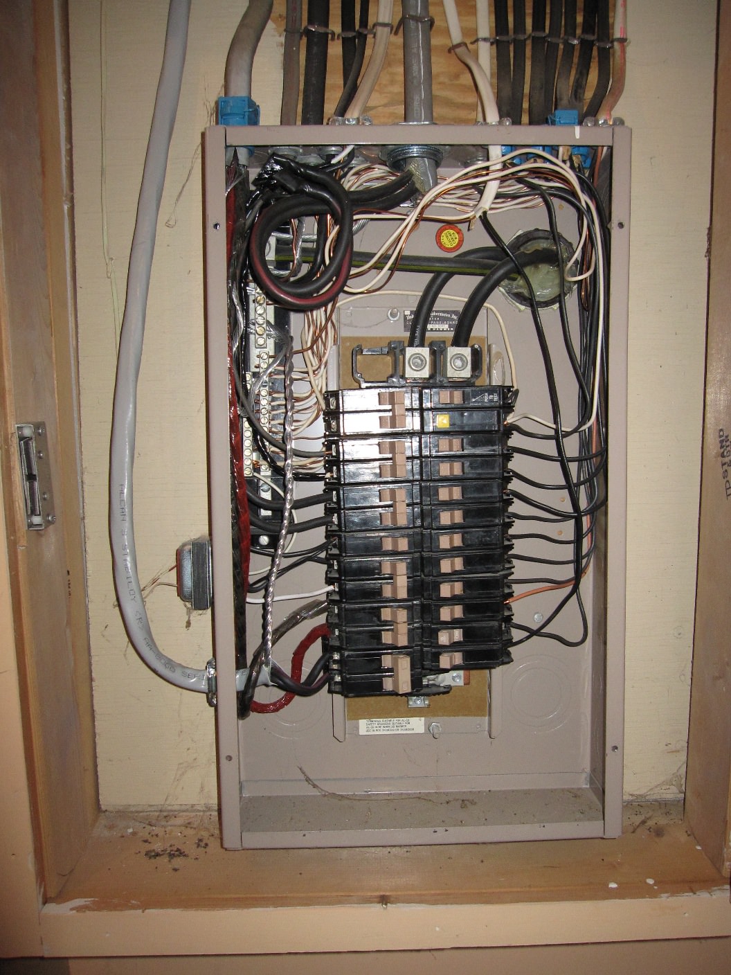

dtontarski Posted June 15, 2009 Report Share Posted June 15, 2009 Please tell me what I am looking at here. This is in a condo. It does not appear to be properly wired as either a main service panel, or as a distribution panel (sub-panel). I have no clue where a main disconnect might be if one exists. Did Cutler Hammer make a split-buss panel that would support this type of breaker arrangement? Ouch....my head hurts....I've been staring at this for an hour and just can't figure out how this could be right. Download Attachment: Issues.jpg 514.58 KB The double poles running down the left side of the panel are sized as follows top to bottom: 60-30-50,30,30,50 Quote Link to comment Share on other sites More sharing options...
Brandon Whitmore Posted June 15, 2009 Report Share Posted June 15, 2009 Around here, there would be a meter bank with service disconnects for larger condo units. Did you locate the meter? I usually find them in the lowest level of the complex or outside (basement, parking garage, etc.) The interior unit in this case would be non- service equipment. That panel does not appear to be wired as service equipment (no main disconnect/ 6 throw disconnect), nor is it wired properly as non- service equipment. Problem is, I have no idea when they started requiring the separation of the neutral and equipment grounds....... Quote Link to comment Share on other sites More sharing options...

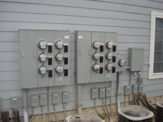

Erby Posted June 15, 2009 Report Share Posted June 15, 2009 It's not. You're right. But as a condo, it should probably be wired as a sub-panel with separated neutrals and grounds. The main disconnect is someplace central, probably close to the meter bank. One I have a picture of looks like this: Click to Enlarge 41.52 KB I'd just list a few of the problems like: Doubled neutrals and grounds Neutrals and grounds on the same bus bar in a sub panel Overheated red wire at bottom right White wires used as hot wires Double tapped/lugged breaker at mid left etc and dump it off to a licensed electrician for repair of those issues and any others the electrician finds while conducting repairs. -It's a great place to be smart and ask questions at, isn't it? Quote Link to comment Share on other sites More sharing options...

Richard Moore Posted June 15, 2009 Report Share Posted June 15, 2009 What others have said...there's probably a service disconnect at a bank of panels hidden away in a room somewhere in the complex which, of course, would mean the neutrals and grounds should be separated. It's either wrong that way, or wrong because of the number of throws. It can not be right! Did Cutler Hammer make a split-buss panel that would support this type of breaker arrangement? Ummm, yes, most likely, but that isn't one of them. There are no feeders from one double-pole breaker returning to anything else in the panel so, unless they have somehow welded the upper and lower busses together behind the breakers, there would be no way for the bottom half to be energized. One final thing...what the hell is going on with that top right (2-pole?) GFCI breaker. There's a short black wire that looks like it's looped from one pole to the other??? Quote Link to comment Share on other sites More sharing options...

Kyle Kubs Posted June 15, 2009 Report Share Posted June 15, 2009 There's quite a bit of heavy stuff in there for a Condo... Is it all electric? (Heat, Stove/oven, water heater, dryer)? Yes CH definitely made a split bus. As has been said, that is not one, but they did make one. Quote Link to comment Share on other sites More sharing options...

Jim Port Posted June 16, 2009 Report Share Posted June 16, 2009 One final thing...what the hell is going on with that top right (2-pole?) GFCI breaker. There's a short black wire that looks like it's looped from one pole to the other??? The older CH GFI breakers were of a 2 pole design space-wise. The black jumper was part of the breaker. Quote Link to comment Share on other sites More sharing options...
