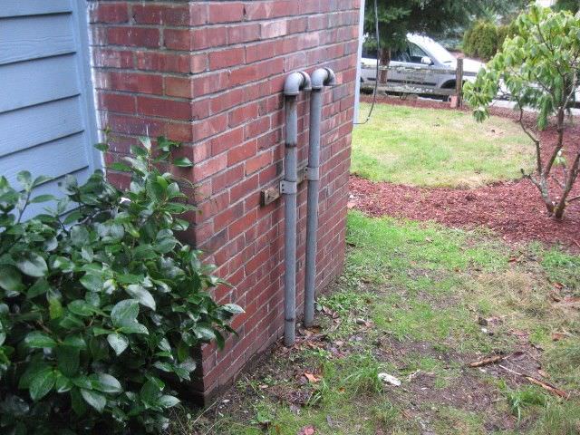

Richard Moore Posted December 22, 2009 Report Share Posted December 22, 2009 I had another inspector/friend shoot me this photo after he called me to see if I knew what these would be for. I don't. I told him I would try the really smart guys here...(but anyone can answer [] ) Click to Enlarge 97.86 KB 1940's house, north Seattle (on public water/sewer) with full unfinished basement, currently gas heat. The fireplace is a normal masonry wood-burner (no air-inlets). Supposedly, there was no sign in the basement of these 2" galvanized pipes entering (or having ever entered). No stove or fireplace in the basement. Too big for a normal buried oil tank vent and would be a very odd place to have them anyway. Anyone? Quote Link to comment Share on other sites More sharing options...

mgbinspect Posted December 22, 2009 Report Share Posted December 22, 2009 Well they look like vents, but for what? Quote Link to comment Share on other sites More sharing options...
MTL_Inspet_Man Posted December 22, 2009 Report Share Posted December 22, 2009 look like some primitive vents or radon traps? Quote Link to comment Share on other sites More sharing options...
Richard Moore Posted December 22, 2009 Author Report Share Posted December 22, 2009 We don't have a radon issue around here, so that is highly unlikely. Venting primitives...maybe. Quote Link to comment Share on other sites More sharing options...
Bill Kibbel Posted December 22, 2009 Report Share Posted December 22, 2009 We sometimes use pipes like that for whiskey stills in Kentucky. The buried ends typically terminate in a safe, easily disguised location. In Kentucky, I'm sure they know better than to allow whiskey to touch galvanized steel. I've seen many "bomb shelters" and storm cellars with similar vents. Quote Link to comment Share on other sites More sharing options...
Inspector37620 Posted December 22, 2009 Report Share Posted December 22, 2009 May be combustible air for fireplace. If there is a hollow cavity under firebox they could have routed the pipe into the ash dump under firebox and the draw from the flue brings in air from outside. Just a guess. Quote Link to comment Share on other sites More sharing options...
Richard Moore Posted December 22, 2009 Author Report Share Posted December 22, 2009 May be combustiion air for fireplace. If there is a hollow cavity under firebox they could have routed the pipe into the ash dump under firebox and the draw from the flue brings in air from outside. Just a guess. That was my first guess, but he says it is just a normal fireplace. I don't know if there was an ash dump or if he looked in it. I can't see an exterior cleanout door in the photo. Maybe they had some type of stove insert that has long since been removed and the firebox restored. Quote Link to comment Share on other sites More sharing options...

mgbinspect Posted December 22, 2009 Report Share Posted December 22, 2009 Twin abandoned underground fuel storage tanks? Quote Link to comment Share on other sites More sharing options...
Rob Amaral Posted December 22, 2009 Report Share Posted December 22, 2009 They do look like fuel oil tank vents... I'd be asking them to find out there are 'any underground fuel tanks' on this property (before purchasing it). Quote Link to comment Share on other sites More sharing options...
Bain Posted December 22, 2009 Report Share Posted December 22, 2009 I'd play it safe and caution the client about underground tanks. In real time, though, the pipes may have been installed for some purpose we'll never be able to glean. Around here, I see galvanized pipes used for everything from clothes-line posts, handrails, shelving supports . . . you name it. The first thing I would have done is pull on the pipes and see if they were set in concrete. With all the crazy booshit we see everyday, who can tell what some Joe Homeowner was trying to create or achieve? Quote Link to comment Share on other sites More sharing options...
mgbinspect Posted December 22, 2009 Report Share Posted December 22, 2009 Yup, most of the time vents for old underground fuel storage tanks around here (and there are a TON of them), have come straight up with a little mushroom style cap over them, but now and then they'll just be turned down like that. Had I simply walked up on them, that would have been my automatic assumption - underground tanks. Quote Link to comment Share on other sites More sharing options...
Inspector37620 Posted December 22, 2009 Report Share Posted December 22, 2009 I showed the pic to another inspector I know and he has seen this exact thing. He says without more info that he would say it is old decommissioned fuel tank. Quote Link to comment Share on other sites More sharing options...

Jim Katen Posted December 23, 2009 Report Share Posted December 23, 2009 I showed the pic to another inspector I know and he has seen this exact thing. He says without more info that he would say it is old decommissioned fuel tank. Why would he say it was decommissioned? - Jim Katen, Oregon Quote Link to comment Share on other sites More sharing options...
hausdok Posted December 23, 2009 Report Share Posted December 23, 2009 I showed the pic to another inspector I know and he has seen this exact thing. He says without more info that he would say it is old decommissioned fuel tank. Why would he say it was decommissioned? - Jim Katen, Oregon Yeah, I'd never assume that it's a decommissioned tank. A few years ago, the Department of Ecology estimated there were something like 10,000 abandoned UST's in Seattle that still had oil in them. OT - OF!!! M. Quote Link to comment Share on other sites More sharing options...
Inspector37620 Posted December 23, 2009 Report Share Posted December 23, 2009 Because the ones he saw were done the same way and were not being used anymore. Maybe a better way to have said it would have been its an oil tank. Quote Link to comment Share on other sites More sharing options...
mgbinspect Posted December 23, 2009 Report Share Posted December 23, 2009 The first and automatic thing I start doing as soon as I see anything like those is trying to locate a filler cap flush with the ground in typically a five for or so foot radius of those vents. If you don't find filler caps, it's probably abandoned, but still could have oil in it, or be empty and a possible future problem due to collapse. In the city of Richmond, they must be removed now and some degree of soil contamination is typical. Quote Link to comment Share on other sites More sharing options...
Jim Katen Posted December 23, 2009 Report Share Posted December 23, 2009 Because the ones he saw were done the same way and were not being used anymore. Maybe a better way to have said it would have been its an oil tank. Maybe. Around here, the word "decommissioned" has a very specific meaning. It doesn't just mean that it's abandoned or that it's had it's fill cap removed. To decommission a tank, someone has to open it up, clean it out and fill it with inert material -- usually sand, gravel, or slurry. When this is done, the vent and fill pipes are invariably removed and the oil lines are crimped or capped. It might be that in TN, the word doesn't carry the same meaning. As Mike said, here in the Pacific NW, underground oil tanks are everywhere and pretty much everyone is accustomed to dealing with them. As for the original post, those things might be oil tank vents. But if they are, they're certainly not typical looking. The vents usually have caps. With the things in those pictures, anyone could stuff anything in the vents -- stuff that could contaminate the oil or stuff that could clog the pipes. I doubt that they're oil tank vents. - Jim Katen, Oregon Quote Link to comment Share on other sites More sharing options...
