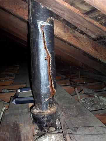

Mike Lamb Posted January 13, 2010 Report Share Posted January 13, 2010 I need to replace this cast iron vent stack in the attic of a bungalow. I'm open to suggestions on the best way to remove it. It has already got a large crack/smile in it. I could break it apart with a hammer but I don't want any chunks to fall into the drain. There is a clean-out in the basement that I can open and put in a rag to catch debris but I still don't want any chunks to fall. Since this pipe is no longer round because of the crack, could I still use a cast iron pipe cutter? Or a Sawzall would be better? Thanks. Click to Enlarge 34.9 KB Click to Enlarge 56.05 KB Quote Link to comment Share on other sites More sharing options...
Jim Katen Posted January 13, 2010 Report Share Posted January 13, 2010 I need to replace this cast iron vent stack in the attic of a bungalow. I'm open to suggestions on the best way to remove it. It has already got a large crack/smile in it. I could break it apart with a hammer but I don't want any chunks to fall into the drain. There is a clean-out in the basement that I can open and put in a rag to catch debris but I still don't want any chunks to fall. Since this pipe is no longer round because of the crack, could I still use a cast iron pipe cutter? Or a Sawzall would be better? Thanks. Rake out the lead & oakum & pull straight up. - Jim Katen, Oregon Quote Link to comment Share on other sites More sharing options...
Mike Lamb Posted January 13, 2010 Author Report Share Posted January 13, 2010 Good idea. I'll try that first but I'm afraid the boot will trap it from above. The roof is fairly steep and we've had plenty of snow. Quote Link to comment Share on other sites More sharing options...
Mark P Posted January 13, 2010 Report Share Posted January 13, 2010 I've only had to do it once. I went to the local tool rental store and got a pipe chain cutter. It worked great, snapped the pipe in two real clean like. Be sure the other sections are properly supported, you donââ¬â¢t want something falling once this section is removed. The tool was kinda of heavy and it took two of us, one to help hold it in place, while the other cranked it. Use safety goggles. http://www.reedmfgco.com/index.html?scr ... pe_cutters Quote Link to comment Share on other sites More sharing options...
Marc Posted January 13, 2010 Report Share Posted January 13, 2010 If it's a lead roof jack then you'll need to straighten the lead so the pipe can come up. Feel queasy about mounting a steep, snow covered roof? That's contracting! Gotta love it. Marc Quote Link to comment Share on other sites More sharing options...

MarkM Posted January 13, 2010 Report Share Posted January 13, 2010 I have had good luck with a 4" angle grinder and an .040 cutoff blade. Quote Link to comment Share on other sites More sharing options...
Bryan Posted January 13, 2010 Report Share Posted January 13, 2010 Lenox makes a diamond blade for the reciprocating saw that works wonders on cast iron. Bryan Quote Link to comment Share on other sites More sharing options...

Jim Morrison Posted January 13, 2010 Report Share Posted January 13, 2010 You don't want to be on a roof like that if it's steep and there's still snow on it. Follow Katen's advice. I'd be surprised if the boot trapped it from above because you can always force it from the attic. If that doesn't work, well...blame Katen. That's what I'd do. Jimmy Quote Link to comment Share on other sites More sharing options...

Bain Posted January 14, 2010 Report Share Posted January 14, 2010 It wasn't the question, but there are also epoxy puttys like FastSteel that are designed to seal cracks like that. Those cast-iron pipes are a lot heavier than they look, so be careful. You'll probably have to use some kind of a band clamp just to gain purchase on the pipe and control it as you lift it up and out. Quote Link to comment Share on other sites More sharing options...

Jim Katen Posted January 14, 2010 Report Share Posted January 14, 2010 What causes cast iron to fail in this manner anyway? I've never seen it anywhere but in stacks. Is it a material defect from the start that just takes years to manifest itself? Good question. It looks like it exploded from the inside. Expansion from frost closure & freezing? - Jim Katen, Oregon Quote Link to comment Share on other sites More sharing options...
