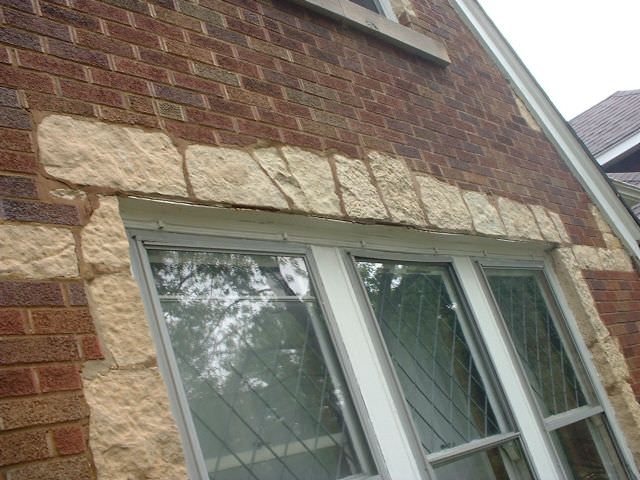

tirebiter Posted August 18, 2009 Report Share Posted August 18, 2009 Here's a little picture of what happens when one happens to "tuckpoint" w/ incompatible mortars. The underlying lime mortar was saturated, new Type N was laid over it, moisture was held into the wall, & resulting freeze/thaw blew the sucker apart in a couple seasons. It has become somewhat of a campaign for me; fine old masonry is being destroyed by the misapplication of modern mortars over the old original lime putty material. Anyone else have experience w/ this problem? If you do, let's talk. This building is only a block away from where the Valentines Day Massacre occurred, for those inclined to be interested in such stuff. Download Attachment: parapet deterioration 2 (WinCE).JPG 8.82 KB Download Attachment: parpet deterioration closeup (WinCE).JPG 8.85 KB kurt couldnt load you examples by the massacre site anything i ought to specify with a tuckpointer before work begins re mortar mix color, sand size, sand grade,. shoud i use natural or portland cement mortar? if natural, oyster shell or limestone source? etc... is a mortar analysis necessary? who does this work? in you opinion, is the crack pattern development at a stage where there is cause for concern? where can you see the masonry being jacked up? which joints show problems? what is the best way to tuckpoint these lintel gaps? this is the tear out you reccommend cheers from the frigid torch environs Click to Enlarge 72.25 KB Quote Link to comment Share on other sites More sharing options...
kurt Posted August 18, 2009 Author Report Share Posted August 18, 2009 You have some time, it isn't that bad, so take time to figure this out. Send a mortar sample in to a lab. This is where I go..... http://usheritage.com/ Someone's already messed it up with some Type N bag mortar along the edges; that's probably part of your problem. Quote Link to comment Share on other sites More sharing options...

kurt Posted August 18, 2009 Author Report Share Posted August 18, 2009 I got the pics fine.....(?).... To answer some of the previous questions; It really isn't bad right now, but it will progressively jack up the brick and accelerate the stairstep cracking pattern. When you get big stairsteps, you get big stairstep repairs that always look like crap. Since what you got looks like some nice work, why not keep it looking nice instead of looking like you waited too long? It's not "tuckpointing". Tuckpointing is a 19th century decorative application on mortar joints, wherein a white "tuck" is applied into a previously struck wet joint. You're doing masonry repair; replacing lintels and rebuilding/pointing the wall. The term tuckpointing has been bastardized for approximately 110 years, starting right here in Chicago. I hate the term tuckpointing, because it means anyone saying it doesn't know what they are trying to do. Words mean things; I am fervently devoted to using the right ones. Understand that "soft" mortar isn't necessarily bad. It provides the expansion capability that masonry walls need. Near as I can tell, the modern "expansion joints" don't do squat, no matter how many you install. When the entire wall can expand and contract, you eliminate the stress that creates miles of hairline cracks that provide the capillary pathways for water to enter the wall. The addition of lime in the mix provides the autogenous healing necessary for masonry to survive; as water moves through lime mortar, it carries molecules of lime with it that seal up all the little capillary pathways that exist naturally in any masonry wall. Avoid "bag mortar" from the big boxes. New steel is not as good as old steel. I have no basis for that comment other than my immediate observations of thousands of lintels on a daily basis. The new stuff rusts wildly and the old stuff doesn't. I don't know why, but you know, I should find out. When you install a new lintel, it is critical that you use flashing to isolate the (new crappy) steel from the water and corrosive masonry. Don't scrimp and use "garbage bag" plastic. Splurge and go for 40 mil self adhering stuff, and don't forget the end dams and interior wythe detailing. I might take a northern Michigan vacation this fall and do a little windsurfing up off Point Betsie, then work my way up to Cross Village and Sturgeon Bay. Maybe I'll swing through Bellaire. I think this may be the oldest thread to be brought back to life....... Quote Link to comment Share on other sites More sharing options...
