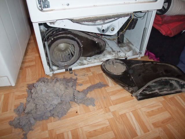

Marc Posted February 12, 2010 Report Share Posted February 12, 2010 I'm taking my dryer apart TODAY to clean it. Hasn't been cleaned since......since.......Pooh Yie, hasn't been cleaned. Marc Quote Link to comment Share on other sites More sharing options...

Marc Posted February 12, 2010 Report Share Posted February 12, 2010 This is the dust that was scooped out by hand from my clothes dryer with just the lower panel cover removed. It's that brown pile on the left. Not shown is another smaller pile of dust taken from the 3' long flexible vent pipe. I think I'll remove the drum and vacuum everything. Marc Click to Enlarge 53.63 KB Quote Link to comment Share on other sites More sharing options...
