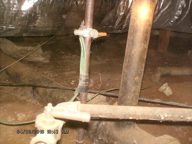

Phillip Posted May 9, 2010 Report Share Posted May 9, 2010 The house had 3 prong receptacles on a two wire system. Some one had run a green wire to in attempt to ground them. The wire going up goes to the receptacles above it then it goes to the other receptacles Click to Enlarge 68.51 KB Then they run to this. Click to Enlarge 61.94 KB Quote Link to comment Share on other sites More sharing options...

Phillip Posted May 9, 2010 Author Report Share Posted May 9, 2010 Life is never boring for you down there, eh? So what's the verdict? Is it better than nuthin? It gives a false sense of wellbeing, I guess. But if the ground clamp connection was always kept clean....? It was not working. Quote Link to comment Share on other sites More sharing options...

Phillip Posted May 10, 2010 Author Report Share Posted May 10, 2010 Hi Bill, You say it didnt work, did all that wiring not even make its way to a panel? Just seems like a lot of work, to not have it work. Steve Originally posted by John Kogel It was not working. Hi Steve, The wires did not go back to the panel and when I tested the receptacles most of them where not showing to be grounded. Quote Link to comment Share on other sites More sharing options...

Jim Katen Posted May 11, 2010 Report Share Posted May 11, 2010 I am no electrician....but, I don't know that just because a tester doesn't pick-up the grounded condition that it isn't technically grounded. If there is no common neutral bus for the ground then would a tester really "see" it as a ground? I am in no way endorsing this wiring as correct but maybe it really is grounded? Just a thought. If a properly working tester doesn't see it as grounded, then it's not grounded. If a properly working tester sees it as grounded, it *might* be grounded. Remember that the thing we call "grounding" at a receptacle has nothing whatsoever, at all, in the least little bit to do with a connection to the earth. "Grounding" at a receptacle means that you have a connection to the service neutral. If you don't have that connection, you don't have a grounded receptacle. In Phillip's original pictures, the idea wasn't bad, just the execution. If you have a old, ungrounded system and you wish to install grounded 3-slot receptacles, you can run a separate equipment grounding conductor to "any accessible point on the grounding electrode system." (250.130©). A metal underground water pipe that's connected to the service neutral is part of the grounding electrode system, but only the first 5' from the point where it emerges from the ground. You can run your receptacle equipment grounds to that first 5' section. (250.52(A)(1)) Also, if you're going to do this, you either have to use #6 wire or you have to make sure that the wire is protected from physical damage. (250,120©) The wires in Phillip's pictures are smaller than #6 and they're not protected from physical damage. - Jim Katen, Oregon Quote Link to comment Share on other sites More sharing options...
