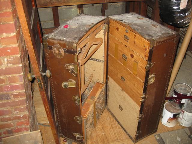

davidlord Posted August 31, 2010 Report Share Posted August 31, 2010 Speaking of trunks. Not uncommon but rarely see them with the drawers and hangers. Click to Enlarge 66.23 KB Link to comment Share on other sites More sharing options...
Ben H Posted August 31, 2010 Report Share Posted August 31, 2010 Speaking of trunks. Not uncommon but rarely see them with the drawers and hangers. Click to Enlarge 66.23 KB American Pickers! Link to comment Share on other sites More sharing options...
