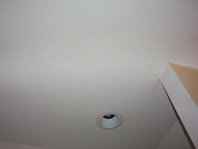

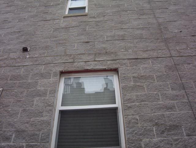

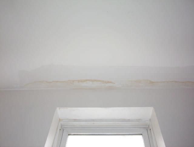

Mike Lamb Posted December 13, 2010 Report Share Posted December 13, 2010 So timely. This is a split-faced block from yesterday's inspection. 4000 S. Ellis. Built 2004. Water was coming through the walls at four different places that were obvious. The worst was patching and water stains from the outside wall across most of the kitchen ceiling to about the middle of the building maybe 14'. There were 2 more levels above but I have to lean to the joist sponge effect Kurt explained because of the lay out. It's really a shame. Click to Enlarge 12.7 KB Click to Enlarge 20.69 KB Click to Enlarge 13.68 KB Click to Enlarge 58.92 KB Quote Link to comment Share on other sites More sharing options...
kurt Posted December 13, 2010 Report Share Posted December 13, 2010 Yes, it is a shame. So many people are so totally screwed because they bought one of these things. I'm developing a slide show to display just how bad this stuff is, and Vi Daley (14th Ward alderperson) is getting me and Steve Hier an audience sometime after the New Year to make our case to the City Council that this stuff should not be allowed on multistory residential buildings with the wood floor platforms. No way are they gonna ban it completely, but there has to be some controls on it, and a strict installation methodology adhered to with regular inspections by, ummmm, me and Steve, and folks we train. We want to develop a training program for inspectors, and have a team of folks that are doing the inspections. If it flies, you'll be on the short list for folks to do the inspectin' (if you're interested). Pie in the sky right now, but we're gonna make our pitch. Quote Link to comment Share on other sites More sharing options...
