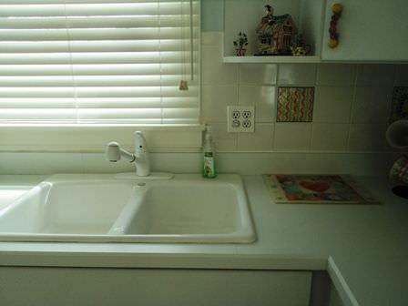

Jerry Simon Posted March 30, 2011 Report Share Posted March 30, 2011 Improper receptacle location above the right side of the sink? Should it be moved, or just changed to a GFCI type? Click to Enlarge 18.77 KB Link to comment Share on other sites More sharing options...
Mark P Posted March 30, 2011 Report Share Posted March 30, 2011 Might consider a GFCI breaker on that circuit, that way they could keep all 4 outlets. Link to comment Share on other sites More sharing options...

allseason Posted March 30, 2011 Report Share Posted March 30, 2011 What about the cords draping into the sink? I would tell them to move it to avoid that problem, gfci or not. Link to comment Share on other sites More sharing options...
Ben H Posted March 30, 2011 Report Share Posted March 30, 2011 Might consider a GFCI breaker on that circuit, that way they could keep all 4 outlets. Seems like a good idea to me. Link to comment Share on other sites More sharing options...
Richard Moore Posted March 31, 2011 Report Share Posted March 31, 2011 What's all this talk about a needing a GFCI breaker to maintain the four outlets? A single GFCI duplex receptacle could easily feed the other duplex and accomplish the same thing. Link to comment Share on other sites More sharing options...

Jim Katen Posted March 31, 2011 Report Share Posted March 31, 2011 Improper receptacle location above the right side of the sink? Should it be moved, or just changed to a GFCI type? Click to Enlarge 18.77 KB If I were inspecting the house, I'd just tell them to make sure that it's GFCI protected. Moving it a few inches away from the sink won't change the risk. - Jim Katen, Oregon Link to comment Share on other sites More sharing options...

John Kogel Posted March 31, 2011 Report Share Posted March 31, 2011 Improper receptacle location above the right side of the sink? Should it be moved, or just changed to a GFCI type? If I were inspecting the house, I'd just tell them to make sure that it's GFCI protected. Moving it a few inches away from the sink won't change the risk. - Jim Katen, Oregon That's what I said in the first place. I said that i'd recommend a GFCI! (If it's not already present). Then, I have no clue of what the hell happened in here! lol, someone said to not listen to the Canadian, who, I think, was right! Sorry Jerry. I think you got your answer(s). Eli, you said either move it or install GFCI. In the US, the code requires all new kitchen receptacles to be on GFCI's, no matter where you moved it to. In Canada, yes, you can move it away from the sink 1.5 meters and not put in a GFCI. We are scary that way. Just making sure you got the code rules straight. GFCI breakers in the panel are required only on the Canadian 15 amp split duplex circuits within 1.5 meters of the sink if the kitchen is being renovated, therefore, if new code rules come into effect in an old kitchen. New kitchen, you will see 20 amp circuits installed using the much cheaper GFCI receptacles. Link to comment Share on other sites More sharing options...

Jim Katen Posted March 31, 2011 Report Share Posted March 31, 2011 Oh i see! So in the US whenever there is a receptacle in the kitchen, it immediately needs a GFCI! Not quite. In the US, GFCI protection is required at all 15- and 20-amp receptacles that serve kitchen countertops. The other receptacles in a kitchen don't require GFCI protection. These might include receptacles behind refrigerators, down low near the floor, inside a cabinet to serve a cooktop, etc. It's true that in Canada you can either move it 1.5 meter away from the pluming system or install a GFCI! That used to be the case in the US also. We became more strict. Now, what I am thinking is, why did Jerry asked that question if the GFCI is mandatory? Moving it or not makes no difference then!? He asked if it should be moved or *just* changed to a GFCI. I think that he's perfectly aware that the GFCI protection is a good idea either way. Maybe it's an old kitchen? Do the rules change in the US if it's an older kitchen or you still need to advice the client about installing a GFCI? The reporting requirements vary from state to state. I believe that some (Texas?) require home inspectors to recommend GFCI installation in certain places. Other states have no such requirements and the decision about what to recommend is left up to the inspector. In Canada, no matters if it's a new house or not, you need to advise your clients to install a GFCI if the receptacle is less than 1.5 meter. Is that a code requirement or a requirement for home inspectors? If a home inspector requirement, who makes that rule? Is the rule nationwide or does it vary by province or city? - Jim Katen, Oregon Link to comment Share on other sites More sharing options...
