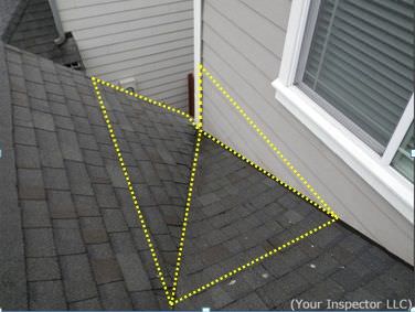

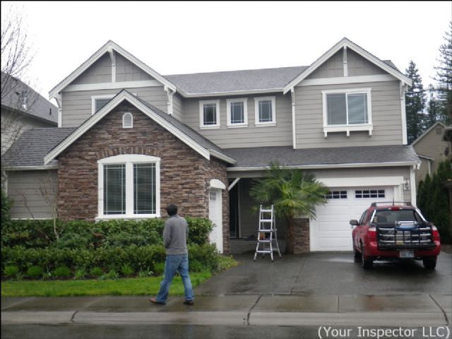

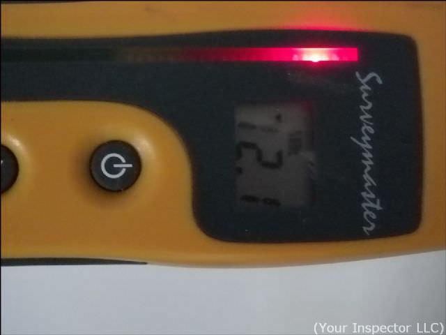

hausdok Posted April 16, 2011 Report Share Posted April 16, 2011 Every time I see one of these I just shake my head and ask myself why it is they don't have mandatory training and education for framing and roofing guys. Yesterday's roof. Click to Enlarge 56.39 KB It was raining like hell when I started, so I did the interior, electro-mechanical, attic and crawlspace first. Here's what I found in the attic of the left garage (left edge of the garage roof at the extreme left in the photo.) Click to Enlarge 58.96 KB Closeup - If the OSB is this black where there is ventilation, it's a safe bet the inside of the garage/living room wall is going to be nasty. Click to Enlarge 61.97 KB The wall is just a tad damp. Click to Enlarge 23.82 KB Leaking through into the crawlspace under the corner of the living room. Click to Enlarge 49.48 KB I'm thinking that the only way to make this work is either completely lining this with IWS or a custom-made metal flashing that conforms to this outline. Click to Enlarge 23.2 KB What say you, Boys? ONE TEAM - ONE FIGHT!!! Mike Link to comment Share on other sites More sharing options...
John Kogel Posted April 16, 2011 Report Share Posted April 16, 2011 I think the mouth of that valley needs to be wider, or it will jam up with debris. The framing crew screwed up because the design is f%&ed. The roofers just started banging down shingles cuz that's all they ever do. Back to the drawing board, eh? The architect could design a cure, but why pay him more money? The triangular piece should slope down from the wall to direct the water out and away. A trough like what you drew, but with slope on both sides. Up here, it would be roofed with torched on mod bit, maybe with an open metal valley so it will flush the leaves and needles out. Link to comment Share on other sites More sharing options...
Jim Katen Posted April 16, 2011 Report Share Posted April 16, 2011 That looks like a really stupid addition. It can't be original, can it? You can make that detail shed water just fine by lining the whole area with IWS. The better solution is to install a new cricket. This time, instead of letting the tip of the triangle come to a point, end it with an 8" wide blunt tip. That will make the cricket a bit more shallow, but it doesn't really matter because you're going to line it all with IWS anyway. Then you'd have an 8" opening instead of a pinpoint opening that a tennis ball could clog up. Link to comment Share on other sites More sharing options...
hausdok Posted April 16, 2011 Author Report Share Posted April 16, 2011 Yeah Jim, I agree. It actually did clog up with a one-inch thick chunk of moss and a bunch of roof granules. The owner says they'd had the roof pressure-washed several times over the years. It's all original. ONE TEAM - ONE FIGHT!!! Mike Link to comment Share on other sites More sharing options...

rittenhousejk Posted April 16, 2011 Report Share Posted April 16, 2011 your outline looks like a pyramid to me w/two sides trapping water against the house & roof. Make a rectangular cricket sloping down from both walls back to the roofline. I agree it should be as wide as possible where it spills off the roof. You're probably limited by the bottom edge of the window but it should be enough height. This space will always need to be checked for debris buildup. Link to comment Share on other sites More sharing options...

hausdok Posted April 17, 2011 Author Report Share Posted April 17, 2011 Snow? Nah, not likely. We got about 10 inches in a storm in January of 1997 but nothing significant since. Ironic that. Less than an hour's drive they had 16ft. of snow through the winter and a week ago a car was pushed across Rt. 2 with all its occupants in it by an avalance. One of the weird percs of living in the western corridor on Puget Sound, I guess. Taking it up those walls about 12 to 15 inches above the bottom would probably do fine. If it were custom made, it would have to have a flange that wraps around that vertical corner behind the trim as well as wraps down over the fascia behind the gutter and on that rake. That friggin piece of vertical trim is about 1/4-inch above the surface of the roof and almost completely fills that tiny little notch. The site super on this job must have been more than mildly retarded. ONE TEAM - ONE FIGHT!!! Mike Link to comment Share on other sites More sharing options...
