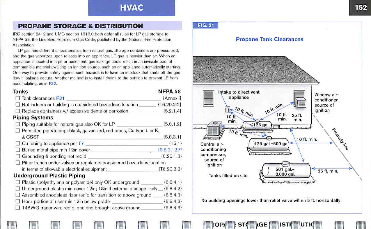

nookandcranny Posted June 22, 2011 Report Share Posted June 22, 2011 I'm inspecting a home tomorrow that has propane heat. Since this is not typical of my area, I'm looking for some pointers. Other than checking to see if the furnace has a sticker on it saying it's been converted to propane, anything else I should check for? Type of piping? Quote Link to comment Share on other sites More sharing options...
Robert Jones Posted June 22, 2011 Report Share Posted June 22, 2011 Handle it like you would a natural gas serviced home and check with your local area muni for specifics on the actual installation of the propane equipment, ie; tank. For example, does it need to be a certain distance from the home? Is the service line from the tank to the home protected? Is there a regulator valve installed? Here, check this link out and enjoy;) http://www.propane101.com/lpgasserviceline.htm Quote Link to comment Share on other sites More sharing options...
Les Posted June 22, 2011 Report Share Posted June 22, 2011 hey Julie, Rob gave you some good advice. I would caution you to not assume it is a converted furnace/water heater etc. Natural gas and propane are quite different. Different combustion, working pressures, etc. Read and apply general gas principles and you will be ok. Quote Link to comment Share on other sites More sharing options...
nookandcranny Posted June 22, 2011 Author Report Share Posted June 22, 2011 Thanks guys I also searched "propane" in the archives and learned a bit as well. A local propane company's # is now in my phone and I'll give them a ring tomorrow to see what piping is acceptable here. Quote Link to comment Share on other sites More sharing options...
fyrmnk Posted June 22, 2011 Report Share Posted June 22, 2011 Although not related to your question, it's also good to recommend they have a propane gas detector/alarm installed in the lowest level/basement IMHO. With propane being heavier than air, you could have a large amount accumulate and go boom long before anyone would smell it in the living area if they get a leak. Quote Link to comment Share on other sites More sharing options...
davidmcg Posted June 22, 2011 Report Share Posted June 22, 2011 Also remember, propane is heavier than natural gas and should not be used in an appliance where the floor level is below grade. If there is a leak, the gas will fill the lower level like water until it reaches a flame then danger of explosion exists. Propane tanks less than 100 gallons can be next to a house. Propane tanks 100 to 500 gallons must be 15 feet or more from home Propane tanks of 1000 gallons or more must be 30 feet from the home Quote Link to comment Share on other sites More sharing options...
davidmcg Posted June 22, 2011 Report Share Posted June 22, 2011 Also, newer installations require regulators at the tank and edge of house prior to penetration. Quote Link to comment Share on other sites More sharing options...
hausdok Posted June 22, 2011 Report Share Posted June 22, 2011 Also remember, propane is heavier than natural gas and should not be used in an appliance where the floor level is below grade. If there is a leak, the gas will fill the lower level like water until it reaches a flame then danger of explosion exists. Propane tanks less than 100 gallons can be next to a house. Propane tanks 100 to 500 gallons must be 15 feet or more from home Propane tanks of 1000 gallons or more must be 30 feet from the home I'm remembering all of those homes in my home town in upstate New York where folks had propane-fired water heaters located below grade in basements. We had one. I can't remember ever hearing about anyone's house blowing up due to propane pooling in the basement. Got a code citation for that restriction? ONE TEAM - ONE FIGHT!!! Mike Quote Link to comment Share on other sites More sharing options...
davidmcg Posted June 22, 2011 Report Share Posted June 22, 2011 I'm remembering all of those homes in my home town in upstate New York where folks had propane-fired water heaters located below grade in basements. We had one. I can't remember ever hearing about anyone's house blowing up due to propane pooling in the basement. Got a code citation for that restriction? ONE TEAM - ONE FIGHT!!! Mike Hi Mike, not exactly a code citation number. But attached here are 2 pages out of Code Check Complete, pages 152 and 153. On page 152 in the second paragraph it begins to go into detail on this and is completed on page 153. Download Attachment: Code Check p152.jpg 100.17 KB Download Attachment: Code Check p153.jpg 87.48 KB Quote Link to comment Share on other sites More sharing options...
hausdok Posted June 22, 2011 Report Share Posted June 22, 2011 There might be an explanation in the first paragraph. It mentions an auto shutoff that detects a loss in pressure. Maybe the water heaters we had in those days were equipped with some kind of device like that. I wouldn't know, I was a kid and wasn't really interested in such things. My workshop was in the basement next to that water heater. I had a table stacked with old bicycles and parts and antique typewriters that I used to fix up. ONE TEAM - ONE FIGHT!!! Mike Quote Link to comment Share on other sites More sharing options...
Bill Kibbel Posted June 22, 2011 Report Share Posted June 22, 2011 Also remember, propane is heavier than natural gas and should not be used in an appliance where the floor level is below grade. If there is a leak, the gas will fill the lower level like water until it reaches a flame then danger of explosion exists.There is no national code requirement prohibiting LP appliance installations below grade. The drain thingy in the diagram is nonsense. LP could only pool "like water" in a completely sealed chamber that lacked any air movement (it isn't gasoline vapor). A LP leak is the same as a NG leak, above grade or below grade. With the correct amount of oxygen present it can ignite. Quote Link to comment Share on other sites More sharing options...
John Kogel Posted June 22, 2011 Report Share Posted June 22, 2011 Quite often there will be two regulators or more on a residential propane system. If the line from the tank is 3/4", usually copper tubing, they will run that at high pressure. Then another regulator near the appliance reduces the pressure to what's needed for the device. The high pressure section will be more prone to leaking, I would imagine. That is, a leak would be more severe. I got rid of the propane furnace that was in this house when I bought it. There were junctions, splices and tees all over the place, scary. I used propane in various camping trailers and was always pretty casual about it, until my wife almost blew herself thru the wall, lighting the oven one night. But she got it lit in time to bake me something, so no harm done. [] Mike, what would cause all the keys on the left side of this old Corona typewriter to stop working? My son and his girlfriend bought it at a garage sale. I haven't seen it up close. Click to Enlarge 47.67 KB Quote Link to comment Share on other sites More sharing options...
Jim Katen Posted June 22, 2011 Report Share Posted June 22, 2011 Also remember, propane is heavier than natural gas and should not be used in an appliance where the floor level is below grade. If there is a leak, the gas will fill the lower level like water until it reaches a flame then danger of explosion exists.There is no national code requirement prohibiting LP appliance installations below grade. The drain thingy in the diagram is nonsense. LP could only pool "like water" in a completely sealed chamber that lacked any air movement (it isn't gasoline vapor). A LP leak is the same as a NG leak, above grade or below grade. With the correct amount of oxygen present it can ignite. LP might not pool like water but, then again, it might. It's 1-1/2 times more dense than air so it can stratify pretty easily. While I think it's a poor idea to put LP appliances in basements, I must admit that my house, which I built, has a propane furnace in the basement. It also has a propane detector at floor level, which operates a solenoid at the gas entrance. If I found a propane appliance in a basement, I'd recommend installing a similar system. Quote Link to comment Share on other sites More sharing options...

Les Posted June 22, 2011 Report Share Posted June 22, 2011 Very interesting discussion. We see approx 1,000 or more propane furnaces, water heaters, etc per year and most are in basements. None have shut downs. Never seen alarm sensor shut down./ Quote Link to comment Share on other sites More sharing options...
Greg Booth Posted June 22, 2011 Report Share Posted June 22, 2011 In my rural area of service, propane furnaces and water heaters are the norm--not the exception. To see any detectors/alarms is rare. In recreational marine installations, propane tank lockers are sealed environments with overboard-drains to allow gas leakage to safely "flow" outside the boat rather than to the bilge. ........Greg Quote Link to comment Share on other sites More sharing options...
fyrmnk Posted June 22, 2011 Report Share Posted June 22, 2011 Very interesting discussion. We see approx 1,000 or more propane furnaces, water heaters, etc per year and most are in basements. None have shut downs. Never seen alarm sensor shut down./ I just make a general recommendation for the alarm similar to also recommending carbon monoxide alarms, letting them know the safety risk and the simple added safety that they can gain. We have very little propane here in my general inspection area, so I only occasionaly deal with it, but never had anyone not understand the potential risks and the simple ways to deal with it. Quote Link to comment Share on other sites More sharing options...
Bill Kibbel Posted June 22, 2011 Report Share Posted June 22, 2011 Anyone have any statistics to back up the claim that an LP appliance is more dangerous than NG appliance when in a basement? Does the "personal experiences" include any incident of pooling LP in a basement was the cause of a catastrophe? I just Googled to try to find any statistics. I didn't find any. The third search result was this: https://www.inspectorsjournal.com/forum ... ic_id=7953 Quote Link to comment Share on other sites More sharing options...
