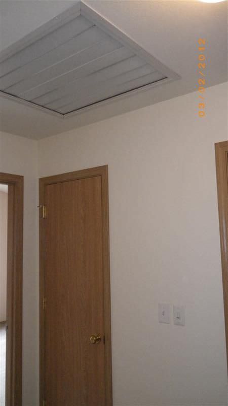

Robert Jones Posted March 2, 2012 Report Share Posted March 2, 2012 Don't run into these up here. Is it simply a fan to help cool the second floor? Noisy as hell! Click to Enlarge 24.44 KB Quote Link to comment Share on other sites More sharing options...
inspector57 Posted March 2, 2012 Report Share Posted March 2, 2012 "Attic Fan" in common parlance but more correctly a whole house ventilator fan. Sucks air out of the house and exhausts inside the attic which should have adequate vents to outdoors. BIG chance of backdrafting of gas appliances and chimneys when in operation. Occupants must open windows to get flow through ventilation. Very useful in hot climates that cool down at night. They were very common here before a/c became popular. Quote Link to comment Share on other sites More sharing options...

Garet Posted March 3, 2012 Report Share Posted March 3, 2012 We have lots of whole house fans. They work well because we get hot during the day and cool off at night. I ran my air conditioner only 1 day last summer. As others have said, you have to open windows for them to work. You need sufficient attic ventilation in order to blow the air out of the attic without pressurizing it. Also, they're energy hogs in the winter because they have no insulation and leak air like a sieve. Dear Dumbass, thanks for enlightening me about another of pitfall of whole house fans. I always appreciate learning at someone else's expense. Quote Link to comment Share on other sites More sharing options...
Bill Kibbel Posted March 3, 2012 Report Share Posted March 3, 2012 A seller decided to demonstrate her whole-house fan to the buyer during my inspection. It was mid-winter with the house closed up tightly. The old giant oil-fired boiler exhaust got sucked right out of the draft-control damper will I was quite near. I felt almost like I might loose consciousness and had a terrible headache for hours. "TURN IT OFF...TURN IT OFF...TURN IT OFF".... thud. Quote Link to comment Share on other sites More sharing options...
John Dirks Jr Posted March 3, 2012 Report Share Posted March 3, 2012 I got one in my house. They are great in certain circumstances such as a cool evening to bring outside air in the open windows. The low setting is not too loud. One drawback is the breach in the insulation qualities of the attic. This drawback can be made worse since these things are sometimes installed in the same hallway where a thermostat is located. I addressed this in my house by building a box with a trap door over the fan unit in the attic. I then insulated the box and trap door. Additionally, I installed a cutoff switch in the attic next to the trap door. When ever the trap door is closed, the cutoff switch in the attic prevents you from turning the fan on in from the wall switch located in the hallway. I'd say the trap door stays closed at least 85% of the year. There's only limited situations where it's beneficial to use these things in my area. If it's not hot or cold, it's humidity we're trying to manage. There's only a few weeks across spring or fall months where it's worth using it. Quote Link to comment Share on other sites More sharing options...
John Dirks Jr Posted March 3, 2012 Report Share Posted March 3, 2012 BTW, whenever you see one of these, check for bottom cord of trusses being cut. Nine times out of ten, that's what happens when they're installed. As I understand, no part of an engineered truss should be cut without an engineered plan of modification. My house is stick built so I get a pass, right? Quote Link to comment Share on other sites More sharing options...
