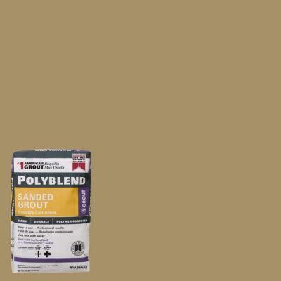

John Dirks Jr Posted April 25, 2012 Author Report Share Posted April 25, 2012 Ok then, I'll go with good old cement based grout in a bag and mix it myself. That is, unless someone thinks there's a better option. If you do, please say so. Quote Link to comment Share on other sites More sharing options...
