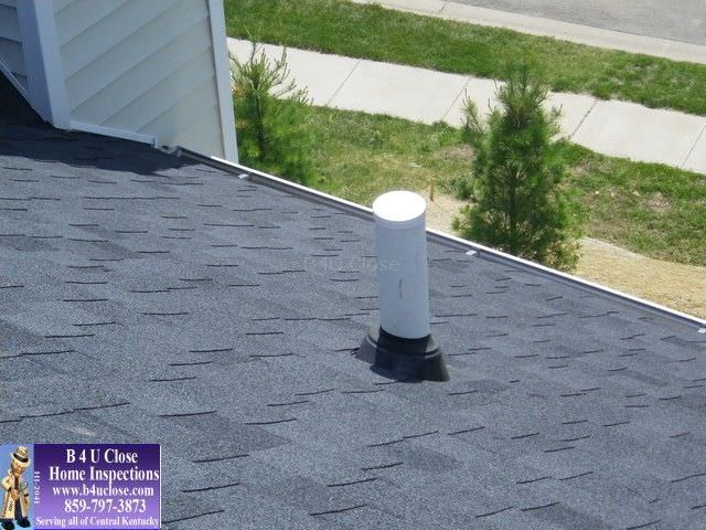

Robert Jones Posted May 4, 2012 Report Share Posted May 4, 2012 New construction. The first floor half bath toilet is very slow to drain. Blockage? What else could cause this? Quote Link to comment Share on other sites More sharing options...

Darren Posted May 14, 2012 Report Share Posted May 14, 2012 My guess is they left a cap on the vent pipe. Quote Link to comment Share on other sites More sharing options...
Erby Posted May 14, 2012 Report Share Posted May 14, 2012 Gee Darren, like this! Who'd think a one year old house still had a pressure test cap on the vent pipe. Click to Enlarge 76.68 KB Quote Link to comment Share on other sites More sharing options...
