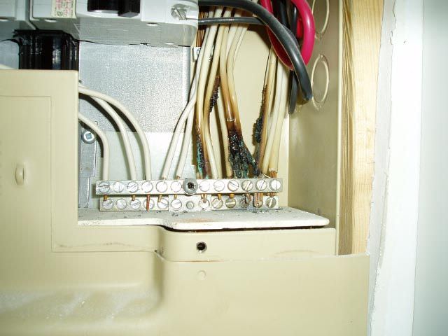

Harley Posted February 1, 2013 Report Share Posted February 1, 2013 Well if it is a loose connection it is probably generating enough heat to discolor the lug at a termination point somewhere and may also be showing signs of melting insulation on the wire. You may want to check for this at the breaker also but in my experience you would have your breaker tripping if that were happening. I would look for signs of heat build up at termination points. Good Hunting! Link to comment Share on other sites More sharing options...
Tom Raymond Posted February 1, 2013 Report Share Posted February 1, 2013 If he's 'win the Mega Ball' lucky it will be loose at an accessible termination. Most likely it's a loose connection in a junction box. If it isn't "in" the house, then it is at the meter or either end of the overhead service cable. It's been a month. If it were a bad transformer it would have popped by now. Link to comment Share on other sites More sharing options...
Jim Katen Posted February 2, 2013 Report Share Posted February 2, 2013 Well if it is a loose connection it is probably generating enough heat to discolor the lug at a termination point somewhere and may also be showing signs of melting insulation on the wire. You may want to check for this at the breaker also but in my experience you would have your breaker tripping if that were happening. I would look for signs of heat build up at termination points. Good Hunting! Possibly so. But I've been surprised to see just how unaffected a loose neutral connection can be. I've seen many that showed absolutely no sign of any kind. Link to comment Share on other sites More sharing options...
Denray Posted February 18, 2013 Report Share Posted February 18, 2013 Found this on the internet once. Click to Enlarge 45.79 KB Link to comment Share on other sites More sharing options...
