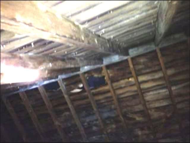

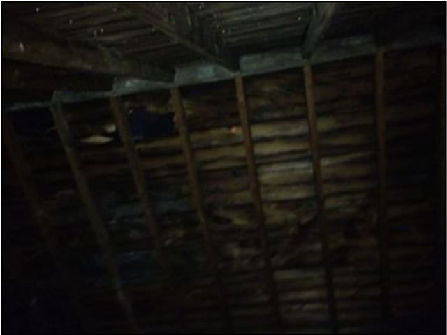

andrewdiesman Posted August 13, 2013 Report Share Posted August 13, 2013 Sorry for the grainy pic, but what do you guys think about the condition of this attic? 1930s house. Click to Enlarge 24.08 KB Click to Enlarge 27.56 KB Click to Enlarge 30.84 KB Click to Enlarge 23.11 KB Quote Link to comment Share on other sites More sharing options...

andrewdiesman Posted August 13, 2013 Author Report Share Posted August 13, 2013 Trying to determine if the attic is properly ventilated / if that's all moldy wood. Blown-in insulation was added to the attic a few years ago apparently. What, in particular, do you want to know? What do you suspect is going on? Quote Link to comment Share on other sites More sharing options...

kurt Posted August 13, 2013 Report Share Posted August 13, 2013 Could be black staining from current leaks or decades ago leaks, could be mold. Could be the lumber was stacked up when the house was being built, got wet and stained, and it's looked that way for 100 years. Hard to know; can't tell much from the pics. If there's no vents, install some vents. Show us an exterior establishing shot. Quote Link to comment Share on other sites More sharing options...

Jim Katen Posted August 13, 2013 Report Share Posted August 13, 2013 Trying to determine if the attic is properly ventilated / if that's all moldy wood. Blown-in insulation was added to the attic a few years ago apparently. What, in particular, do you want to know? What do you suspect is going on? Sorry, I just can't tell anything from the pictures. I'll offer this, though: I rarely see problems associated with ventilation in attics of this age. Air usually moves through them too easily. Quote Link to comment Share on other sites More sharing options...

kurt Posted August 13, 2013 Report Share Posted August 13, 2013 In that age attic, condensation problems would be somewhere way down the probability list. Quote Link to comment Share on other sites More sharing options...

David Meiland Posted August 13, 2013 Report Share Posted August 13, 2013 I can't see shit in those pics either, but I'll offer this. It is possible to insulate an attic that has been problem-free, and cause a condensation problem. You need the right confluence of factors. Perhaps it's an unvented attic that was built with shakes on it, but now has a layer of OSB, felt, and comp. Airflow is much reduced. Perhaps it's in a cold climate. Without much insulation, a lot of heat from the interior migrated up to the attic, and kept things above the dewpoint. Now, someone has blown in a bunch more insulation, so the attic temp is lower, but they didn't air-seal anything, so there's still humidity moving up there from inside, and you have a problem. Not saying that's what you have, because I can't see shit. Quote Link to comment Share on other sites More sharing options...
Brandon Whitmore Posted August 13, 2013 Report Share Posted August 13, 2013 Is there rust on the new roofing nails that penetrate the sheathing? That will help determine if this is a past/ present issue. Not saying that there is an issue, only because your pictures are well, uhhhh........ Quote Link to comment Share on other sites More sharing options...
Neal Lewis Posted August 13, 2013 Report Share Posted August 13, 2013 What's the white stuff on the sheathing? Any chance there was a slate shingle roof on there at one time? And what's with this Century home terminology? Quote Link to comment Share on other sites More sharing options...

Bill Kibbel Posted August 14, 2013 Report Share Posted August 14, 2013 That's old plank sheathing for a slate, tile or wood roof covering. There were lots of previous leaks and there's some really busted up boards. I can't tell if there's any current moisture from condensation or previous leaks from here. What's the roof covering over it now? Click to Enlarge 32.97 KB Gary, his IP address is in Toronto. That's quite a swim across lake Ontario to inspect in NY. Quote Link to comment Share on other sites More sharing options...
