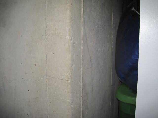

kust Posted August 22, 2013 Report Share Posted August 22, 2013 I will buy 7 years old house, but I found 3 walls have horizontal crack in basement, please see attached pictures. The crack is 1/16 of an inch wide. From there the crack does go about 12 feet in total long and also on outside of concrete wall, on same position there is same thin horizontal crack. In basement I found some mold spot, it is in corner close to heat water tank. Could you like to tell me that is big issue or not ? If need to fix how much about? Thanks. Click to Enlarge 33.25 KB Click to Enlarge 33.91 KB Click to Enlarge 66.51 KB Click to Enlarge 33.74 KB Click to Enlarge 24.6 KB Click to Enlarge 37.7 KB Quote Link to comment Share on other sites More sharing options...

gtblum Posted August 22, 2013 Report Share Posted August 22, 2013 Are you sure that's a crack and not a cold joint? What did your home inspector say about it? Quote Link to comment Share on other sites More sharing options...
kust Posted August 22, 2013 Author Report Share Posted August 22, 2013 I did inspection, inspector said as long as there is no lateral movement it should not be a problem. He recommend monitor horizontal crack in foundation annually. But he is not structural engineer, I am still worry. Every body think that I need to hire structural engineer? Please tell me Thanks. Quote Link to comment Share on other sites More sharing options...
Marc Posted August 22, 2013 Report Share Posted August 22, 2013 Given what I can see from the photos, I don't see any reason to bring in an engineer. Marc Quote Link to comment Share on other sites More sharing options...
Erby Posted August 22, 2013 Report Share Posted August 22, 2013 Looks like a cold joint between concrete trucks pouring to me. Concrete: Guaranteed to do two things. 1. Get hard 2. Crack Quote Link to comment Share on other sites More sharing options...
kust Posted August 23, 2013 Author Report Share Posted August 23, 2013 Thank you for all replies. I still have questions below. In second picture, you can see a crack, it goes about 20 feet along light dark color in top picture, and the crack always under the light dark color. 1)this is Cold joint??? not horizontal crack? 2) cold joint always is with a crack line? and it is so long? 3) cold joint always has crack on both side (inside and outside) of foundation wall? 4) crack of cold joint is getting worse when house gets old, cold joint is not stable? 5)White power was caused by leaking from crack of cold joint? 6) do I need to fix this crack if I buy this house? 7)Do I need to hire a Structural engineer to look the crack and get a stamped report, so I can show next buyer in future when I need to sell . Sorry, too many questions, it is first time to buy house. Thank you everybody. Click to Enlarge 43.46 KB Click to Enlarge 33.91 KB Click to Enlarge 40.73 KB Quote Link to comment Share on other sites More sharing options...

kurt Posted August 23, 2013 Report Share Posted August 23, 2013 First, please listen to Hockstein. Get the best inspector in your area to check it out; it's hard to know for sure over the internet. Second, it does not look serious; it's a cold pour line, with a small crack. It means the foundation contractor wasn't scheduling their trucks in and out very well; the first placement didn't bond fully to the second placement. Cold pour lines are not often a serious condition; can be, but not often. Do not make a purchase decision based upon our observations; really, get an inspector to help you on site. It's worth the money. Quote Link to comment Share on other sites More sharing options...

Jim Katen Posted August 23, 2013 Report Share Posted August 23, 2013 Thank you for all replies. I still have questions below. In second picture, you can see a crack, it goes about 20 feet along light dark color in top picture, and the crack always under the light dark color. 1)this is Cold joint??? not horizontal crack? It's both. 2) cold joint always is with a crack line? and it is so long? Cold joints almost always have cracks associated with them. They are as long as they are. If you had a 100 foot long cold joint, you'd have a 100 foot long crack. 3) cold joint always has crack on both side (inside and outside) of foundation wall? Yes. 4) crack of cold joint is getting worse when house gets old, cold joint is not stable? Well, that's the question, isn't it? The cold joint is a weak spot in the wall. Whether or not that weak spot will ever matter can't be known without knowing what kind of lateral loads will be imposed on the wall in the future. That said, cold joints are very common in older houses and we seldom see ongoing problems associated with them. If your foundation was otherwise well designed and if you control the water in the soil around the house, the overwhelming likelihood is that these cold joints and cracks will never be an issue for you. 5)White power was caused by leaking from crack of cold joint? The white powder is called efflorescence. When water moved through the concrete, it picks up soluble minerals. When that water evaporates on the interior surface of the wall, it leaves those minerals behind in the form of a white powder. It's harmless. 6) do I need to fix this crack if I buy this house? The only repair that you might want to make is to seal it to prevent further water entry. That would best be done from the exterior, and that would require excavation. Trying to patch it from the interior would be sketchy. 7)Do I need to hire a Structural engineer to look the crack and get a stamped report, so I can show next buyer in future when I need to sell . If you really need the peace of mind, then go for it. But, frankly, there's little that a stuctural engineer can tell you at this point. The best thing that you can do is keep your gutters clean, slope the surrounding soil away from the house, and make sure that all of your roof water gets directed well away from the foundation. If water entry through the cracks becomes a problem, have them sealed from the outside. Glance at the cracks every so often to make sure that they aren't getting bigger or bulging inward (an exceedingly unlikely possibility). Quote Link to comment Share on other sites More sharing options...

Jim Katen Posted August 24, 2013 Report Share Posted August 24, 2013 Thank you so much Jim Katen. Last question if fix it how much about ? Thank you again. I don't know. Since I'd advise fixing it from the outside, the cost will depend on how easy it will be to excavate around your house. Is there landscaping? Flatwork? Associated structures (sheds, fences, etc)? Quote Link to comment Share on other sites More sharing options...

Marc Posted August 24, 2013 Report Share Posted August 24, 2013 Even well-built houses can sometimes be damaged by earthquakes. I don't see a major structural fault and would not make a big deal out of that cold joint if I were to write the report but if you worry a lot maybe you'll like to see other houses. Just to end the worry. Marc Quote Link to comment Share on other sites More sharing options...
Jim Katen Posted August 24, 2013 Report Share Posted August 24, 2013 For crack issue in basement ,I want know this house will fall at earthquake or become tilt by itself several years later? I still worry, I am first buy house, but I real like this house. Thank you. If an earthquake happens, the house might or might not be severely damaged, but the cold joints and cracks will probably not play a part one way or the other. Likewise, the cracks will certainly not cause the house to tilt. That's just not one of the possibilities. The worst thing that can happen as a result of these cold joints and cracks is that the foundation could bulge inward if it's stressed by a large enough force from outside. This is unlikely. I see hundreds, or perhaps thousands, of houses that have such cold joints and cracks for every one that I see with inward bulging at the crack. Furthermore, you have some ability to control the risk by controlling water near the foundation. If I liked this house, I would not let the cold joints and cracks prevent me from buying it. Imperfections are not the same thing as defects. Sometimes you need to accept imperfections - just like with a marriage. Are you married? Is your spouse perfect or does he or she have a few cold joints and cracks? Quote Link to comment Share on other sites More sharing options...
