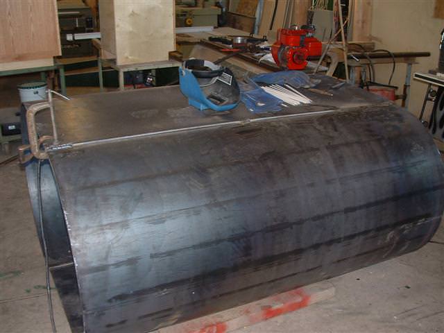

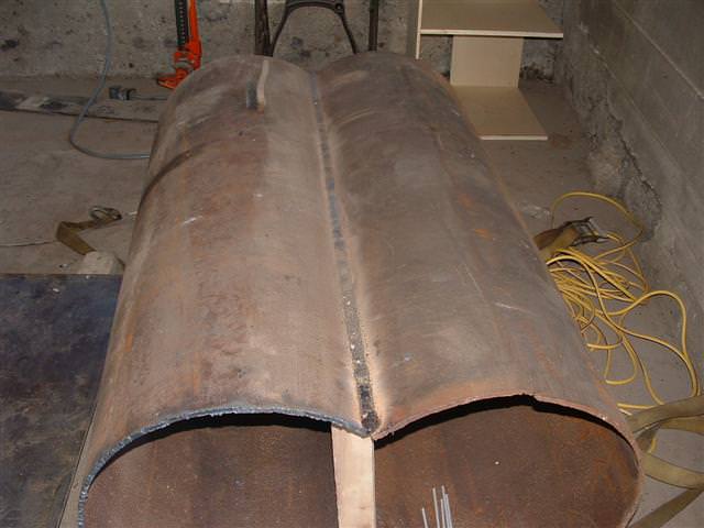

Chad Fabry Posted September 26, 2005 Report Share Posted September 26, 2005 I started building another wood burning "boiler" this past weekend. I'm posting pics just in case anyone's interested. The fire chamber on this one is 24 inches across, 42 inches high and five feet long. It weighs 1700 lbs and is 1/2" thick. The tank is 3/8" and I treated myself to new materials for a change. The tank weighs 1800 lbs. The fire chamber and tank are all welded up now even though they're not in the pics. So far it's taken 40 lbs of rod. One pass w/ AC to fill and then two passes DC reverse polarity to be sure it's water proof. I'll post some progress pics when I get the fire chamber in the tank. Download Attachment: fire1.JPG 45.39 KB Download Attachment: fire2.JPG 41.23 KB Download Attachment: poortruck.JPG 59.74 KB Download Attachment: tank.JPG 43.36 KB Download Attachment: tank1.JPG 49.66 KB 1 Quote Link to comment Share on other sites More sharing options...
kurt Posted September 26, 2005 Report Share Posted September 26, 2005 Ummmm, whaddaya gonna do w/it? Are you going to build a river boat w/ a paddlewheel? Quote Link to comment Share on other sites More sharing options...
Chad Fabry Posted September 26, 2005 Author Report Share Posted September 26, 2005 It'll heat my home and domestic water. It'll be about a hundred and fifty feet from the house and I pump the water from the boiler to a heat exchanger in my furnace plenum. The combustion air blower will kick on @ 120 degrees of water temp, burn a hot, fast, furious fire until water temp is 200 and then shut off combustion air. If boiler temps fall below a hundred, the combustion air also shuts down because that means the fire is out and there's no point blowing icy winter air through the heat exchanger. An added benefit will be to my cats that live in the barn because they'll be able to snuggle up to the expansion tank. The last unit I built was 1600 gallons and it's currently heating the home and shop of my sister and brother in law. This time I made the boiler capacity less and will store 600 gallons of the heated water in my basement. The heat loss off the tanks will be better used inside my home instead of outside. Quote Link to comment Share on other sites More sharing options...

Terence McCann Posted September 27, 2005 Report Share Posted September 27, 2005 Is that ASME rated? [] Quote Link to comment Share on other sites More sharing options...
Chad Fabry Posted September 27, 2005 Author Report Share Posted September 27, 2005 One thing I'm not is a risk taker when it comes to containing heated, or possibly, super heated water. The system is open to atmosphere. When I was a kid and I read about the expansion rate of water when it turns to steam, a friend and I welded up a gallon of water in a 4 inch pipe. We then put it in a big fire and watched from what we thought was a safe distance. After an hour or so we went inside because we figured the container was too strong to burst. As we were watching tv we were surprised to hear and feel the explosion which literally knocked things off the walls in our cottage. It was the first in a summer long series of entertaining explosions. Quote Link to comment Share on other sites More sharing options...
