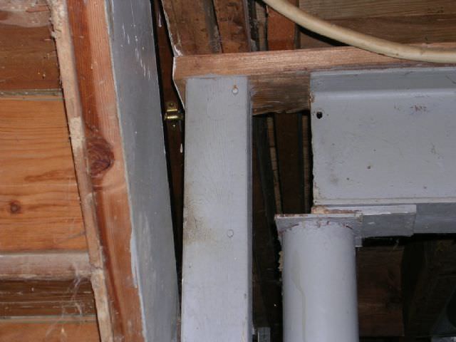

Bill Kibbel Posted September 26, 2005 Report Share Posted September 26, 2005 Yesterday's Inspection: According to the research of Arlene Puentes, (a friend and colleague from Kingston, NY) it doesnââ¬â¢t matter. She also notes that the height adjusting screw must be disabled after installation by encasing in concrete, welding or destroying the threads. www.octoberhome.com/draft/adjustcolumn.html Link to comment Share on other sites More sharing options...

Les Posted September 27, 2005 Author Report Share Posted September 27, 2005 Download Attachment: DSC01964.jpg 553.73 KB How 'bout this? Common practice in the Great Lake State! Editors note: sorry about the size of photo. Link to comment Share on other sites More sharing options...
Chad Fabry Posted September 27, 2005 Report Share Posted September 27, 2005 That's just wrong. Link to comment Share on other sites More sharing options...

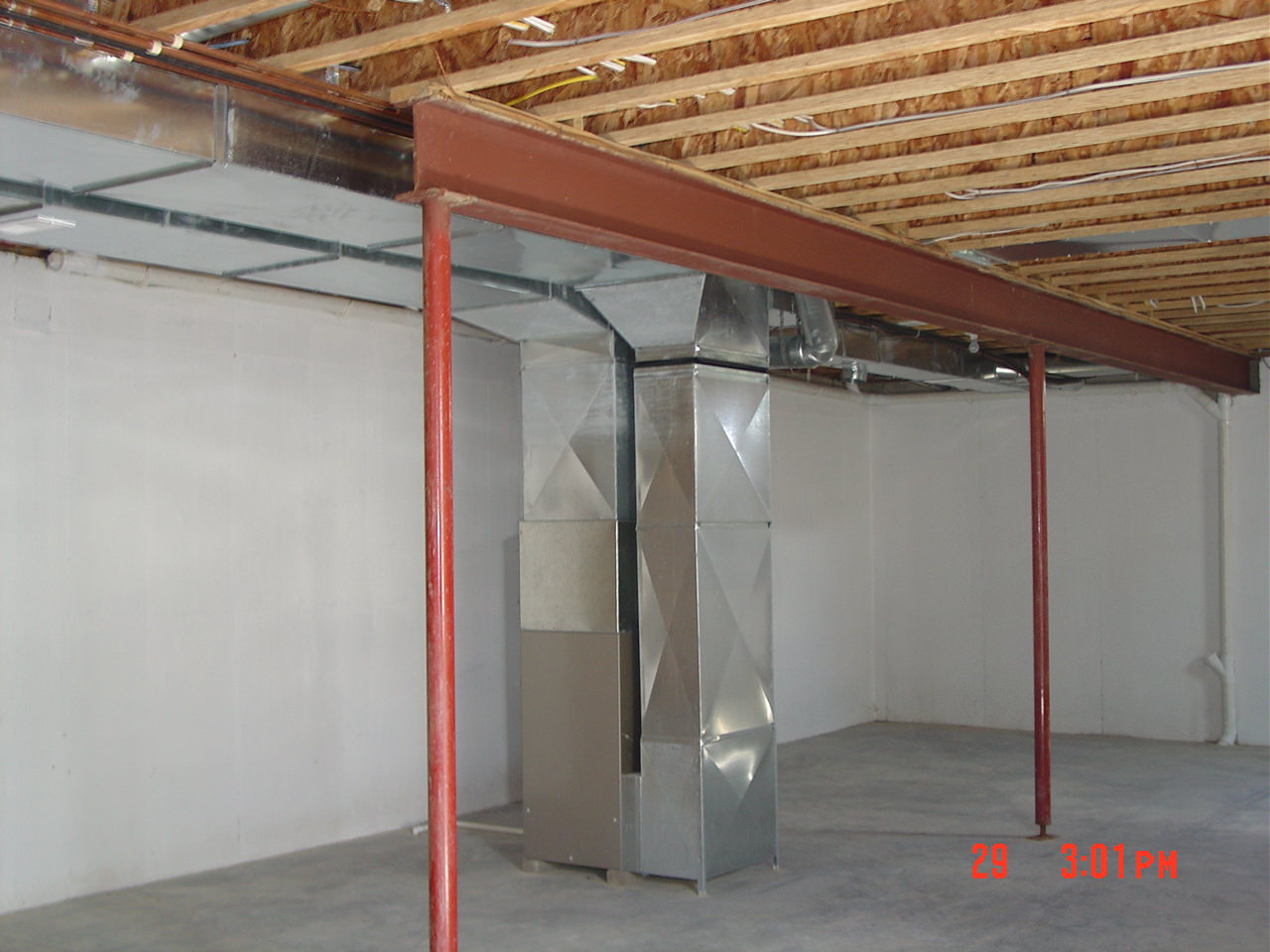

Les Posted September 28, 2005 Author Report Share Posted September 28, 2005 This was the situation that started all my questions. There are six post in this new house. Four like the photo and two with screw at top. All support steel beam that is midpoint in tji's on approx 30' spans. No footings on any, screw end plates not secured, all had layers of dirt, all threads are lubricated for ease of adjustment, none are plumb, three are supporting their own weight only, etc.. Local municipal building official specified them. I been doing this for a long time and have become an arogant SOB, but on this job I had a little doubt creep in because none of this made any sense (common). Thought I would ask my partners in crime what they routinely comment on. During legal cases I have heard reasoning from; screw at top, screw at bottom, no screw, lube screw end to prevent torque, thread load, thread load after welding or breaking and bending, effect of concrete on un-protected metal, fasteners too close to edge of wood beam, size and type of fasteners, footings type and size, "push vs pull" argument, how does encasement in concrete change point load, etc.. I am sure we can come up with many more questions in a free for all discussion. Like Scott P said "Never really thought of it" Thanks for the comments! Link to comment Share on other sites More sharing options...
Chad Fabry Posted September 28, 2005 Report Share Posted September 28, 2005 The point load at the base will be huge after those plates rust out and they will. If it's a typical basement with 3500 psi concrete (or less) the point loads from the screw could exceed the capacity of the concrete to support the post. Once the post has moved down at all, the loads on the adjacent posts just became 50% greater, and in some cases the load would be doubled. Another thing: The photo that the Honorable Kibbel posted is of a two piece adjustable post. That post really is for temporary use and I've never seen one rated at more than 2500 lb capacity. They're junk. The posts that are one piece, are available in 6 inch increments with the screw making the difference between the sizes. The better ones in 4 inch are rated for 12,000 lbs. I lifted a 1600 sq ft ranch with two beams, 2 jacks and 6 of those posts and installed a new basement under the house. There was other bracing, but the posts supported the weight of the structure for the five days of demo and rebuild. Link to comment Share on other sites More sharing options...
