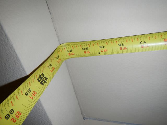

Robert Jones Posted January 26, 2014 Report Share Posted January 26, 2014 What say you. I inspected a new contruction home. HE furnace located in the attic. The scuttle opening measured 23.5" x 21.5". Seems small to me. Click to Enlarge 30.22 KB Click to Enlarge 28.18 KB Quote Link to comment Share on other sites More sharing options...
Marc Posted January 26, 2014 Report Share Posted January 26, 2014 R807.1 Attic access.Buildings with combustible ceiling or roof construction shall have an attic access opening to attic areas that exceed 30 square feet (2.8 m2) and have a vertical height of 30 inches (762 mm) or more. The rough-framed opening shall not be less than 22 inches by 30 inches (559 mm by 762 mm) and shall be located in a hallway or other readily accessible location. A 30-inch (762mm) minimum unobstructed headroom in the attic space shall be provided at some point above the access opening. See Section M1305.1.3 for access requirements where mechanical equipment is located in attics. This is per the 06' IRC. Marc Quote Link to comment Share on other sites More sharing options...
Steven Hockstein Posted January 26, 2014 Report Share Posted January 26, 2014 What say you. I inspected a new contruction home. HE furnace located in the attic. The scuttle opening measured 23.5" x 21.5". Seems small to me. Click to Enlarge 30.22 KB Click to Enlarge 28.18 KB I would say "The attic access opening is X x X. Opening is too small to easily access the attic, especially because there is mechanical equipment in the attic that needs to be regularly serviced (and replaced in the future). I recommend that a larger access opening be provided." You found the problem, tell them why it is an issue, and recommend what to do about it. Quote Link to comment Share on other sites More sharing options...
Robert Jones Posted January 26, 2014 Author Report Share Posted January 26, 2014 Thanks Steven. I did just that. Here is what I stated; "In my opinion, the attic scuttle is not the correct size. Because the furnace is located in the attic cavity, the opening/scuttle, needs to be large enough to allow for removal of the equipment should something go wrong. By my measurements, the scuttle is 23.5" x 21.5" in size. Quote: R807.1 Attic access. (2006 IRC) Buildings with combustible ceiling or roof construction shall have an attic access opening to attic areas that exceed 30 square feet (2.8 m2) and have a vertical height of 30 inches (762 mm) or more. The rough-framed opening shall not be less than 22 inches by 30 inches (559 mm by 762 mm) and shall be located in a hallway or other readily accessible location. A 30-inch (762mm) minimum unobstructed headroom in the attic space shall be provided at some point above the access opening. See Section M1305.1.3 for access requirements where mechanical equipment is located in attic." Quote Link to comment Share on other sites More sharing options...
Erby Posted January 27, 2014 Report Share Posted January 27, 2014 I would have quoted them the Mechanical section, not the Residential section that doesn't apply, due to the furnace located in the attic. (Last sentence of your code quote.) Quote Link to comment Share on other sites More sharing options...
Charles46 Posted January 27, 2014 Report Share Posted January 27, 2014 I think I would have just quoted section M1305.1.3 which will give you opening requirements specifically for this case and also states "large enough to allow removal of the largest appliance." in the 2012 version which we are under here. Quote Link to comment Share on other sites More sharing options...

hausdok Posted January 30, 2014 Report Share Posted January 30, 2014 This is a new home. There's no better time to get it corrected than right now and at the same time you are taking the opportunity to educate the builder or site super on something that might not have been on his/her radar. The residential code requires a "rough opening" size of not less than 22 inches by 30 inches for an ordinary attic access opening, which means the finished hatch - assuming 1/2-inch drywall - would be 21 inches by 29 inches, which is still longer than what you've described. However, your attic contains HVAC equipment and that means the mechanical code applies - not the residential code. The mechanical code requirement is that the passageway to the opening must be large enough to bring the equipment through if it requires replacement and there needs to be sufficient headroom above the opening to be able to tip the equipment up and angle it through the opening. Then the finished access opening needs to be not less than 20-inches by 30-inches or at least large enough to remove the largest piece of equipment. I'd simply write something like: The last time I looked at the mechanical code for HVAC equipment installed in an attic, the code stated that the finished access opening had to be a minimum of 20-inches wide by 30-inches long and at least large enough to accommodate removal of the largest piece of HVAC equipment installed in the attic. The finished access opening to the attic in this house measures 21-1/2 inches by 23-1/2 inches, which is obviously smaller than the smallest opening allowed. I recommend you bring this to the builder's attention now. Ask the builder to have someone measure the equipment installed in the attic, to determine what is the smallest hatch size that can be used, and then have the opening modified to meet that requirement while not being smaller than the minimum finished size of 20-inches by 30-inches that's required. That tosses it back in the builder's lap without a specific code cite. If the builder has a thimble full of brains he/she will look it up or call the local code guy, who will look it up, and they'll arrive at the truth and make corrections as needed. Maybe I'd get a phone call from the client complaining that I was wrong, that the builder showed him the latest version of the code and it allowed a smaller opening - or maybe he'd state that the builder checked with the local code guy and the local code guy confirmed that the smaller opening was fine. In a case like that I'd remind the client that I am not a code guy and that I didn't base my remarks on the latest version of the code as held in my hand. I'd tell him/her to personally double-check with the local code person to ensure that the builder has the facts straight and at that point I'd wash my hands of the issue and let the client work it out, or not, with the builder. No report creep involved. Simple statement of the truth as I saw it and let the chips fall where they may. If the builder gets obstinate advise the client to double-check with the local code official. If I do less and it gets ignored, and five years from now the furnace goes toes up and can't be removed from the attic without major costly modifications, it won't be the builder that gets blamed - it'll be me for not pointing it out when it could have been easily fixed prior to the client taking possession of the home. FWIW A few years ago I squeezed through an access opening that was 14-3/4 by 14-3/4 inches and about 17-1/2 inches on the diagonal. Anyone that's ever met me in person is saying to himself right now, "No friggin' way O'Handley; you're lying through your teeth," but I assure you it's true. The agent yelled up to me, "Mike, are you going to be able to get out of there?" I yelled back, "Don't think so. How about calling my wife and have her stop by about twice a week to bring me some sandwiches and switch out the slop bucket." I got out easier than I got in. Pretty sure I couldn't do that today. The "large" jacket I put on the other day felt like it was designed for a midget. I think it's time I started working on my weight again. ONE TEAM - ONE FIGHT!!! Mike Quote Link to comment Share on other sites More sharing options...
mlparham Posted January 31, 2014 Report Share Posted January 31, 2014 What say you. I inspected a new contruction home. HE furnace located in the attic. The scuttle opening measured 23.5" x 21.5". Seems small to me. Click to Enlarge 30.22 KB Click to Enlarge 28.18 KB Just quote common sense. "The attic access opening is not large enough to remove and replace the air handler that is located in the attic. If the attic access opening is not enlarged by the builder before you buy the home then it will be your responsibility to enlarge the opening when replacement of the air handler is needed." Quote Link to comment Share on other sites More sharing options...
