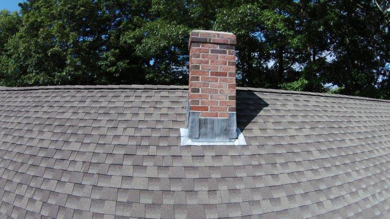

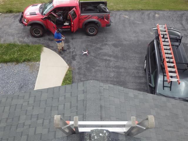

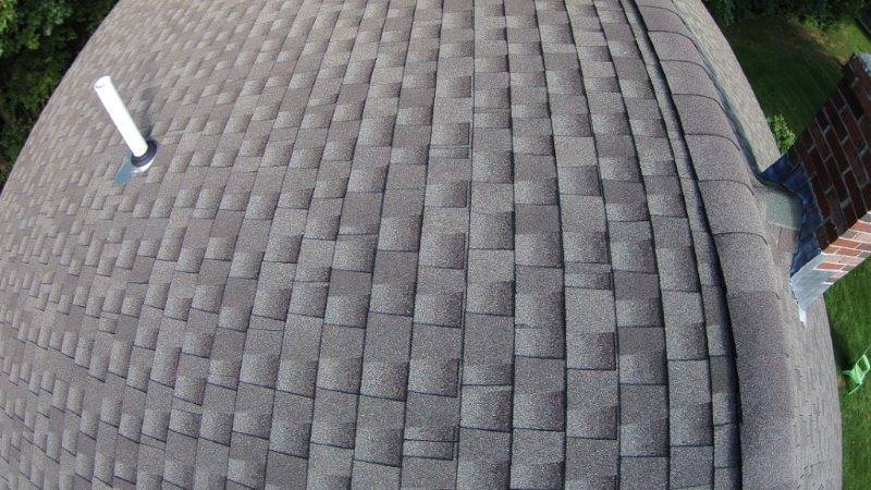

JohnC Posted August 18, 2014 Report Share Posted August 18, 2014 Here is a video link to my 1st few drone flights. Was very windy but not to hard to control. It took about 8-10 minutes to look at the roof and video & take many photos. I need more a lot more practice before using on a real job. But see definite potential for some more difficult roofs. Also here are some photos taken with it. So far very pleased. John Callan [utube]https://www.youtube.com/watch?v=ZepZCfjKxY8&feature=youtu.be" type="application/x-shockwave-flash" wmode="transparent" width="425" height="344"> [utube] " type="application/x-shockwave-flash" wmode="transparent" width="425" height="344"> [utube] " type="application/x-shockwave-flash" wmode="transparent" width="425" height="344"> Click to Enlarge 53.6 KB Download Attachment: Roof Photo using Drone camera.jpg 93.38?KB Download Attachment: Roof Photo with Drone camera.jpg 97.28?KB Quote Link to comment Share on other sites More sharing options...
Marc Posted August 18, 2014 Report Share Posted August 18, 2014 Nice demo of the bird. Too far away from roof/wall surfaces to garner any points as an inspection tool IMHO. Marc Quote Link to comment Share on other sites More sharing options...

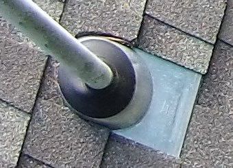

JohnC Posted August 18, 2014 Report Share Posted August 18, 2014 [:-taped]quote]Originally posted by Marc Nice demo of the bird. Too far away from roof/wall surfaces to garner any points as an inspection tool IMHO. Marc Actually I didn't try to look at the walls yet-just tried it out(short flight) but it can get very close to roof as the chimney top photo clearly shows. I can get very close to roofs and walls. It is very stable as the camera is on a gimbal and it links to up to 8 satellites to know its position-not a toy like some drones. (AR Parrot comes to mind) By the way battery is good for 25 minutes. But it is newer technology and not right for everyone yet. But heck I remember when some folks thought photos in a report was a waste of time. Here is another close up photo. John Callan Click to Enlarge 30.25 KBd). Quote Link to comment Share on other sites More sharing options...
