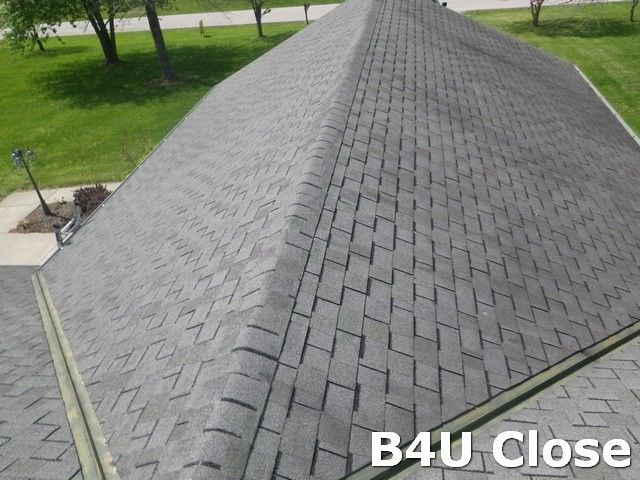

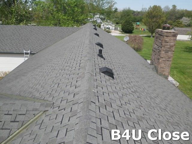

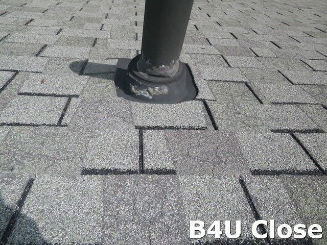

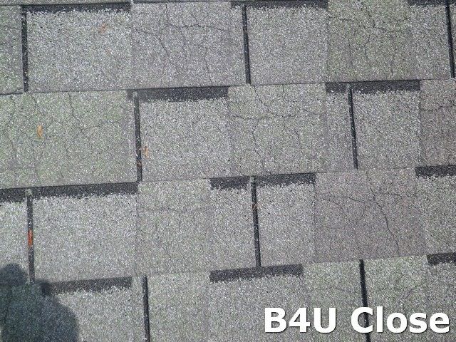

Erby Posted April 27, 2014 Report Share Posted April 27, 2014 A whole bunch of them all cracked up! Anybody remember the particular name of these? Click to Enlarge 78.95 KB Click to Enlarge 75.7 KB Click to Enlarge 110.52 KB Click to Enlarge 119.63 KB Quote Link to comment Share on other sites More sharing options...
Jim Katen Posted April 27, 2014 Report Share Posted April 27, 2014 I don't know the name. All of the fissures seem to be on the double-thick, laminated, areas. If that's the case, they're unlikely to have any effect on the performance of the shingles. Quote Link to comment Share on other sites More sharing options...
Erby Posted April 27, 2014 Author Report Share Posted April 27, 2014 As you noted, the cracks are all on the double laminate section. Seen it before quite a few times several years ago, just can't remember the name. Quote Link to comment Share on other sites More sharing options...
Ben H Posted April 27, 2014 Report Share Posted April 27, 2014 Horizon. Still lots of houses around here that have them, including my own. Quote Link to comment Share on other sites More sharing options...
Bill Kibbel Posted April 27, 2014 Report Share Posted April 27, 2014 There's also another brand with the same issue. I can't remember the name. It's a 3-tab shingle with an "applique" - an additional layer of unreinforced asphalt and granules added in spots to create a decorative, dimensional enhancement. The manufacturers state the "map" cracks are cosmetic. Quote Link to comment Share on other sites More sharing options...
John Dirks Jr Posted April 27, 2014 Report Share Posted April 27, 2014 Pabco is another one. http://www.ho25settlement.com/faq.php3 Quote Link to comment Share on other sites More sharing options...
Robert Jones Posted April 27, 2014 Report Share Posted April 27, 2014 I see quite a bit of the Pabco shingles, from the mid 90's, that have that issue. Quote Link to comment Share on other sites More sharing options...
Ben H Posted April 27, 2014 Report Share Posted April 27, 2014 Must be a region thing, never heard of Pabco. Quote Link to comment Share on other sites More sharing options...
Bill Kibbel Posted April 28, 2014 Report Share Posted April 28, 2014 Must be a region thing, never heard of Pabco. They were only distributed way out West. Quote Link to comment Share on other sites More sharing options...
mlparham Posted April 28, 2014 Report Share Posted April 28, 2014 A whole bunch of them all cracked up! Anybody remember the particular name of these? Click to Enlarge 78.95 KB Click to Enlarge 75.7 KB Click to Enlarge 110.52 KB Click to Enlarge 119.63 KB What is the age of the roof? It looks like an Atlas Chalet. Quote Link to comment Share on other sites More sharing options...
mlparham Posted April 28, 2014 Report Share Posted April 28, 2014 Must be a region thing, never heard of Pabco. They were only distributed way out West. And that some how applies to Kentucky? Please elaborate. Quote Link to comment Share on other sites More sharing options...
Bill Kibbel Posted April 28, 2014 Report Share Posted April 28, 2014 Must be a region thing, never heard of Pabco. They were only distributed way out West. And that some how applies to Kentucky? Please elaborate. Uh, did you read the quoted text I was responding to? Quote Link to comment Share on other sites More sharing options...
Jim Katen Posted April 28, 2014 Report Share Posted April 28, 2014 Must be a region thing, never heard of Pabco. They were only distributed way out West. And that some how applies to Kentucky? Please elaborate. I take it to mean that the problem isn't limited to CertainTeed, but spans a range of manufacturers across different parts of the country. Quote Link to comment Share on other sites More sharing options...
Rob Amaral Posted April 29, 2014 Report Share Posted April 29, 2014 From horse's mouth (Certainteed rep here at plant in Norwood MA) "Cracking in the 'applique' (like that) is 'ok'.. (Versus 'cracking through the reinforcement' (the fiberglass-mat). "It's considered OK in the industry and by the manufacturer. An aesthetic anomaly" Quote Link to comment Share on other sites More sharing options...
