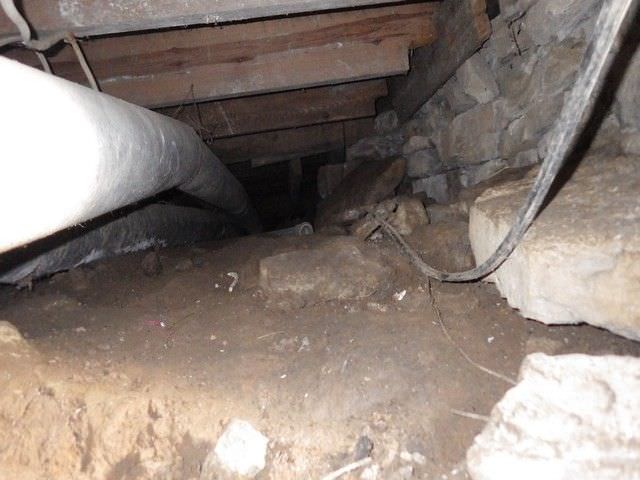

Erby Posted September 16, 2014 Report Share Posted September 16, 2014 Every time I run into one of those "it's too small", "it's too hard", etc I think to myself that there's something in there that's going to come back and bite my butt if I don't get in there, gear up, go in and sure as hell, almost every damn time, there's something there that makes me glad I made the effort. Click to Enlarge 54.83 KB Click to Enlarge 54.58 KB Of course, if you're 350 pounds with a 60 inch waist, I guess it'd be a different story. Quote Link to comment Share on other sites More sharing options...

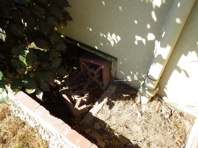

gpdewitt Posted September 20, 2014 Report Share Posted September 20, 2014 So, how many of you guys carry a shovel and dig out the crawlspace access? Click to Enlarge 65.09 KB Quote Link to comment Share on other sites More sharing options...
