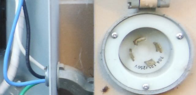

Denray Posted October 29, 2015 Report Share Posted October 29, 2015 Not much power going to it. What do you think it would be used for? Click to Enlarge 23.1 KB Quote Link to comment Share on other sites More sharing options...
kurt Posted October 29, 2015 Report Share Posted October 29, 2015 It's a receptacle that locks a similarly designed plug; I have them on my extension cords to keep them from coming apart. Quote Link to comment Share on other sites More sharing options...
Marc Posted October 29, 2015 Report Share Posted October 29, 2015 What Kurt said, locking weatherproof inlet (not plug, not receptacle). NEMA L10-30. Yours is likely there for a portable power plant, up to about 7 kilowatt (about 14 HP). Marc Quote Link to comment Share on other sites More sharing options...

Jim Port Posted October 30, 2015 Report Share Posted October 30, 2015 It is an inlet so someone does not use a suicide cord to feed power back into the panel. Was there an interlock on the panel? Quote Link to comment Share on other sites More sharing options...

John Kogel Posted October 30, 2015 Report Share Posted October 30, 2015 So what do you call those locking plug and receptacle things? Twist locks? Yeah, that's it. Marc I found this - "NEMA L14-30 locking Extension power cords are 125/250 volts and four wire. Locking plugs have the pins arrayed in a circular manner. The plug is inserted and twisted to lock in place."'Locking plugs' The item in Denny pic is a recessed inlet box. Quote Link to comment Share on other sites More sharing options...

hausdok Posted November 5, 2015 Report Share Posted November 5, 2015 RV plug-in or auxiliary generator plug in. ONE TEAM - ONE FIGHT!!! Mike Quote Link to comment Share on other sites More sharing options...
