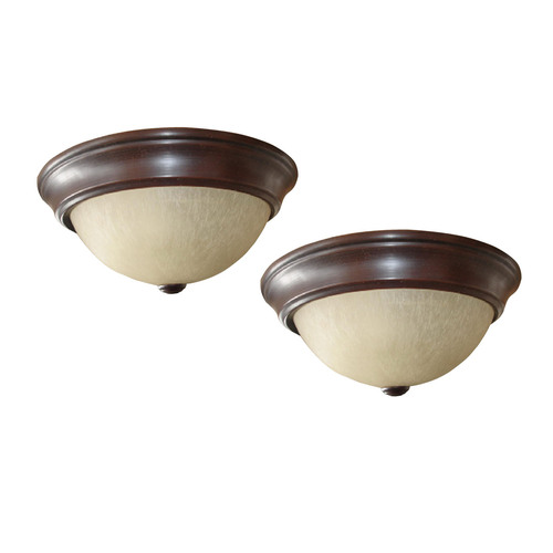

BADAIR Posted November 13, 2018 Report Share Posted November 13, 2018 Quote Link to comment Share on other sites More sharing options...

Jim Katen Posted November 13, 2018 Report Share Posted November 13, 2018 2 hours ago, AHI in AR said: OK...I'll bite. I know it's an old thread but I haven't visited in quite a while. That said, I just HAVE to know just what the horrid "boob lights" are that you refer to. Do they sag? Have some sort of stretch marks? Point in semi-random directions? Are they present in oddly mismatched pairs? Ahem. Barry posted perfect examples of the offending fixtures rendered in oiled bronze. These things seem to have appeared in the '80s (like most horrible house products) and have just about taken over the I-can't-decide-what-kind-of-fixture-I-want-but-I-have-to-install-something-so-I'll-just-install-the-cheapest-piece-of-crap-that-I-can-find niche. I'm ashamed to say that I have one installed in my very own, personal house. Every time I walk under it, I can feel my soul being sucked up into it. Quote Link to comment Share on other sites More sharing options...
AHI in AR Posted November 13, 2018 Report Share Posted November 13, 2018 9 hours ago, Jim Katen said: I'm ashamed to say that I have one installed in my very own, personal house. Every time I walk under it, I can feel my soul being sucked up into it. I think I can help, Jim. Your problem is that you only have one but they are intended to be placed in pairs. Bad feng shui. 1 Quote Link to comment Share on other sites More sharing options...
