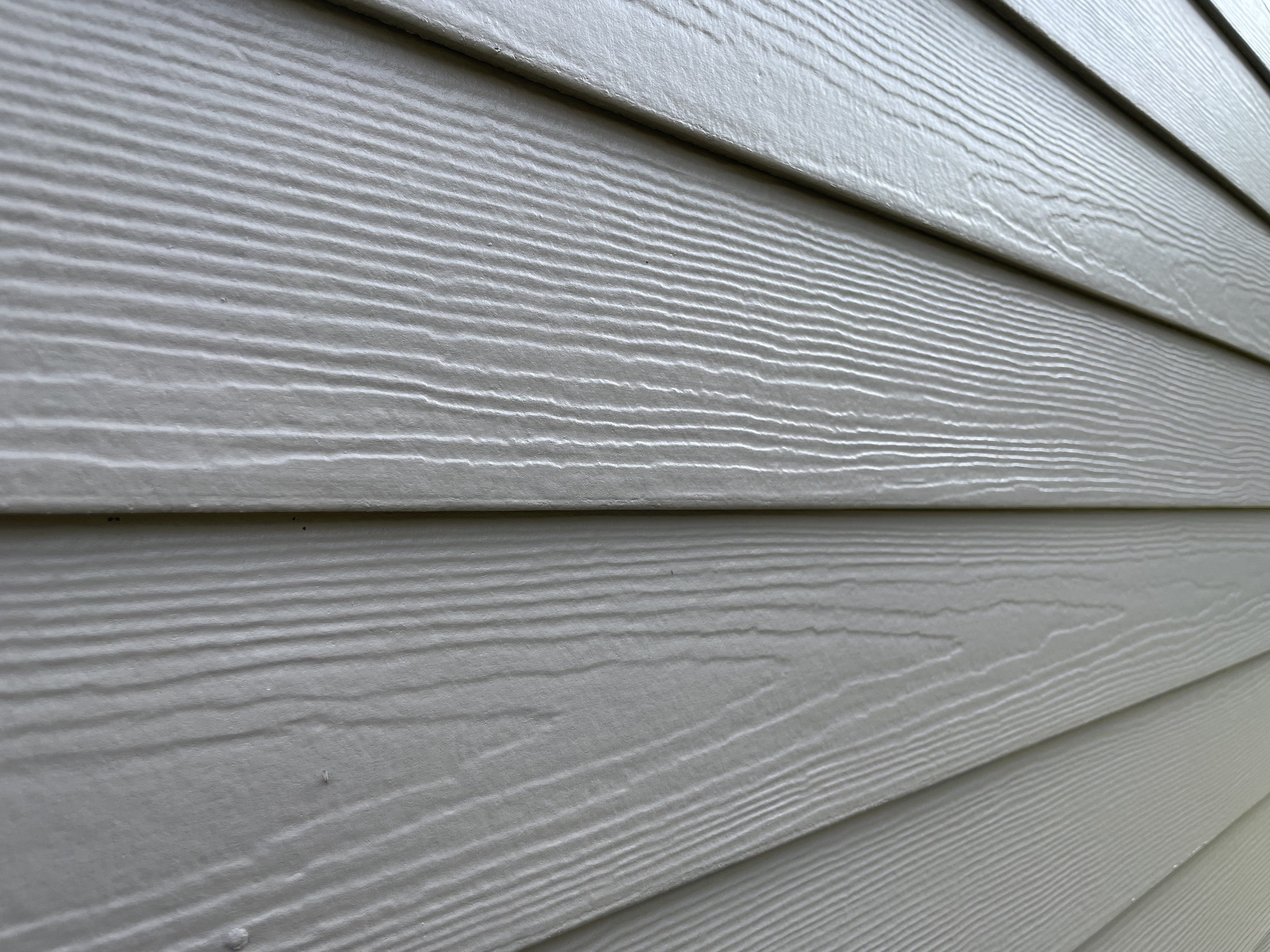

JayneEVHI Posted June 5, 2020 Report Share Posted June 5, 2020 Does anybody have a pic of what Hardie Board looks like? Quote Link to comment Share on other sites More sharing options...

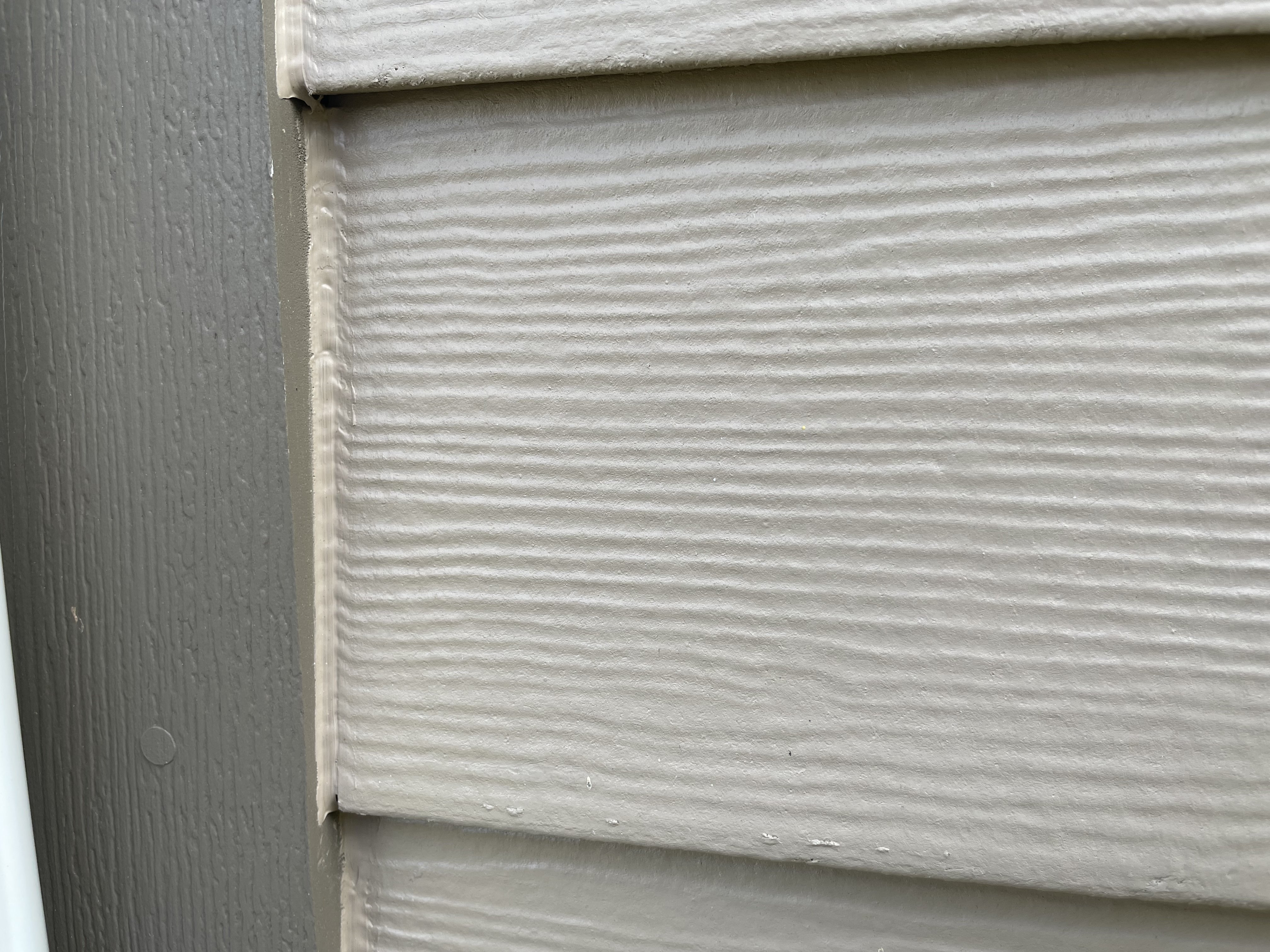

Larry Fontana Posted August 5, 2021 Report Share Posted August 5, 2021 JayneEVHI I just installed Hardie on my home. Here are some close ups. Quote Link to comment Share on other sites More sharing options...
Jim Katen Posted August 6, 2021 Report Share Posted August 6, 2021 That's just one pattern. They make several. Anyone who wants to know what it looks like can just go to their website. Quote Link to comment Share on other sites More sharing options...

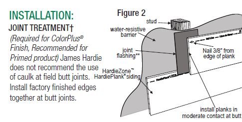

Trent Tarter Posted August 6, 2021 Report Share Posted August 6, 2021 Typically you caulk joints between trim. You do not caulk the butt joints in siding, joint flashings are required at butt joints. The joint flashings can be metal or poly material such as "Bear Skin" flashing sheets. See attached document for more info. hardieplank-hz5-us-en.pdf Quote Link to comment Share on other sites More sharing options...
