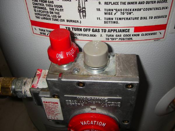

Mark P Posted October 29, 2006 Report Share Posted October 29, 2006 Can someone please tell me what the name and purpose of the tan (not black) round knob on top of the the thermostat. Thank you Download Attachment: 1.jpg 43.09 KB Link to comment Share on other sites More sharing options...
Chad Fabry Posted October 29, 2006 Report Share Posted October 29, 2006 As a rule one must hold that knob down while lighting the pilot until the thermocouple gets hot enough to generate 2-6 millivolts and allows the gas valve to open. Alternatively, it may be a Lego some kid put there. Link to comment Share on other sites More sharing options...
Neal Lewis Posted October 29, 2006 Report Share Posted October 29, 2006 I would also go with the Lego theory, since the diameter of the knob is smaller and can now be pushed down without the gas control in the pilot position. Link to comment Share on other sites More sharing options...
Mark P Posted October 29, 2006 Author Report Share Posted October 29, 2006 Thanks, Well the reason I'm asking is that I inspected this WH, detected a small gas leak from where the pilot light tub connects to the control box and wrote it up. 3 days later was contacted by the selling ageant saying the pilot had gone out, since I live close by and the sellers don't speak much english would I stop by take a look and expalin whatever needed to be explained to them. (like hire a plumber as the report stated) anyway when I stoped back by I found this knob was broken completly off, I told them there was nothing I could do and to call a plumber, they pretended like they new nothing about the knob, well they paid over $400 for a new theromcouple and control box for this 10 year old heater and they want me to pay for it. I'm having to write a letter explaning the facts and providing pictures, etc and I wanted to know what the stupid knob was called. Link to comment Share on other sites More sharing options...
Bill Kibbel Posted October 30, 2006 Report Share Posted October 30, 2006 If it's the button that you depress during, and shortly after, lighting the pilot, it's simply called the reset. It holds open the gas interrupter temporarily until the thermocouple tells the electromagnet to keep it open. -------------------------------------------------- I fear you may have been framed. Not to mention a gas control valve is about $65.00. Link to comment Share on other sites More sharing options...

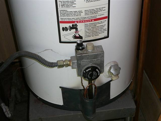

paul burrell Posted October 30, 2006 Report Share Posted October 30, 2006 The gray flex gas line is a recalled item approximately 4 years past +-. I have a flyer on the recall that I received at ASHI meeting. The gray flex tends to break and leak at fittings. There is still a lot of it out there and I call it to be replaced with stainless steel flex or yellow up graded flex. I do not see gray flex on newer homes anymore. Paul B. Link to comment Share on other sites More sharing options...
Mark P Posted October 30, 2006 Author Report Share Posted October 30, 2006 Okay, thanks, I guess I'll refer to it as the "reset button" Link to comment Share on other sites More sharing options...
Jim Katen Posted October 31, 2006 Report Share Posted October 31, 2006 Originally posted by paul burrell The gray flex gas line is a recalled item approximately 4 years past +-. I have a flyer on the recall that I received at ASHI meeting. The gray flex tends to break and leak at fittings. There is still a lot of it out there and I call it to be replaced with stainless steel flex or yellow up graded flex. I do not see gray flex on newer homes anymore. Paul B. If you've still got that flyer or know of a link, please post it. I'm familiar with the faulty brass flex connectors, but I've never heard of a problem with the grey ones. I see a ton of them so if they're defective, I need to know about it. - Jim Katen Link to comment Share on other sites More sharing options...
Bain Posted October 31, 2006 Report Share Posted October 31, 2006 I saw a grey gas-line today, and remembered this post. Without anything concrete, I didn't mention the line as a defect. Link to comment Share on other sites More sharing options...
Bill Kibbel Posted October 31, 2006 Report Share Posted October 31, 2006 Bad connector, uncoated brass: OK connectors: I'll bet the flyer that was passed out had a black & white line drawing and many HIs assumed it was the gray connectors. I really need to clean out my hard drive. Link to comment Share on other sites More sharing options...

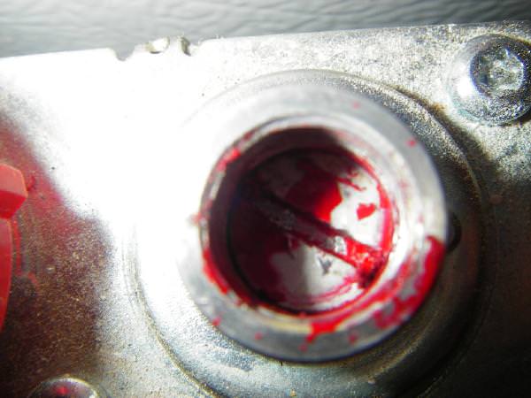

homnspector Posted November 1, 2006 Report Share Posted November 1, 2006 Mark, that cap covers a regulator adjustment that varies the gas flow and output of the burner flame. This is a GE water heater manufactured by Rheem. I don't know who manufactures the control. Apparently Fort Knox if it costs $400. On these controls, the black knob is pushed down to light the pilot, not the tan cover. If it is broken or missing it doesn't make any difference, replace it with Chad's Lego. Here are some Pics Download Attachment: IMGP9728.JPG 52.81 KB Download Attachment: IMGP9729.JPG 42.09 KB Link to comment Share on other sites More sharing options...
