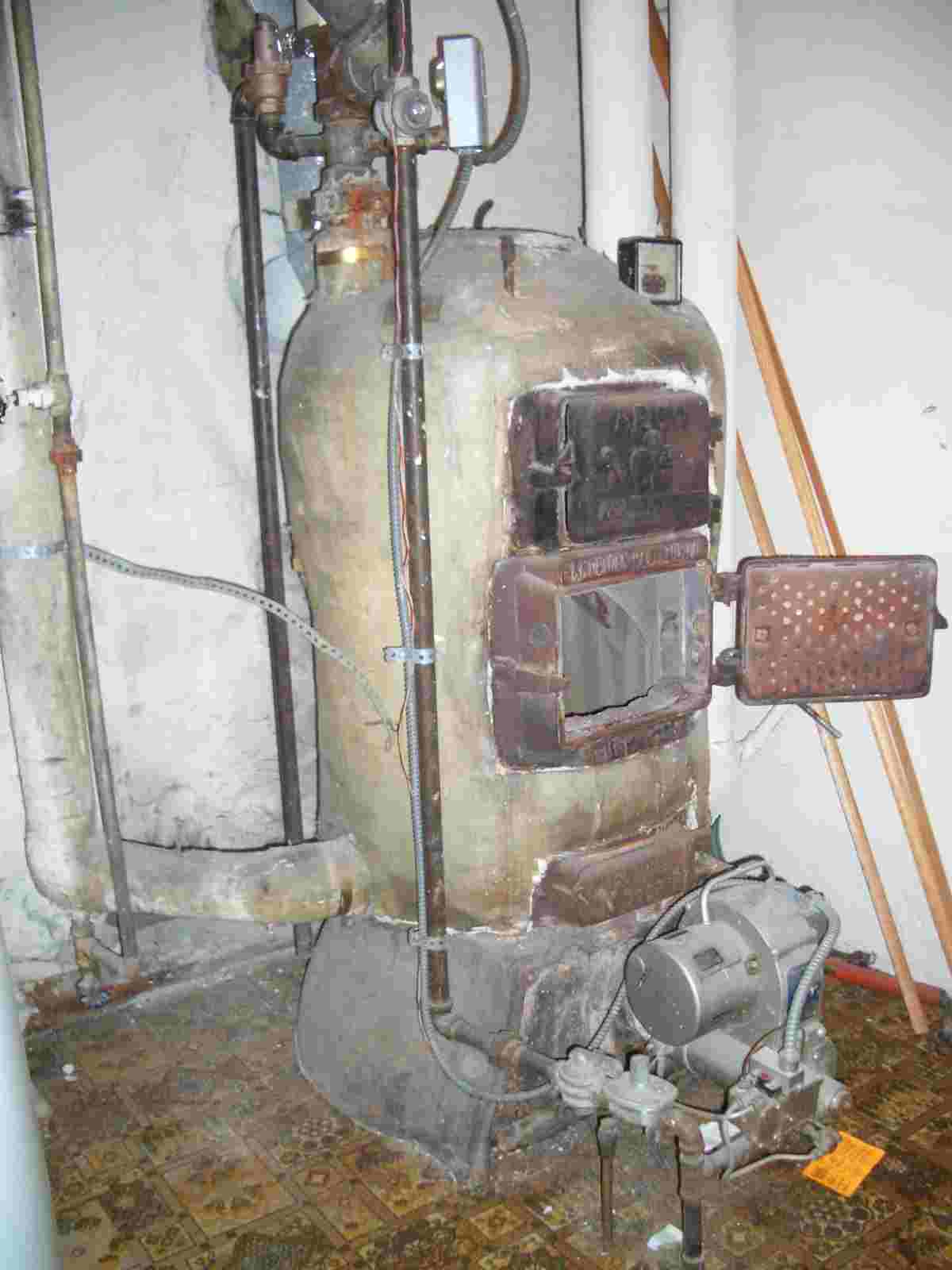

randynavarro Posted January 20, 2007 Report Share Posted January 20, 2007 Well, I probably see one of these about once every 5 years or so. Any words of wisdom on some intelligent reporting language? Does it just need to be replaced cuz its way old? Its still working and heating the place. Download Attachment: BoilerJPEG.jpg 67.53 KB Quote Link to comment Share on other sites More sharing options...
Jesse Posted January 20, 2007 Report Share Posted January 20, 2007 First check all over for exaust gases leaking from anywhere. 99.9% of the time, you'll find it, then say: "The boiler is over thirty years old, and is well beyond its expected service life. It is leaking exaust gases, which is hazardous. The boiler and nearby plumbing is likely insulated with asbestos. Have the boiler serviced by a qualified contractor experienced with older boilers, to ensure safe operation. The boiler may have to be replaced." Then warn the client that it may continue to work forever, and it may crap-out tomorrow. It is terribly inefficient, and should probably be replaced. Replacing it will be expensive, moreso due to the asbestos issue. That's me. Be gentle with your critiques. Ah, screw it, let it rip! Quote Link to comment Share on other sites More sharing options...

Jim Katen Posted January 20, 2007 Report Share Posted January 20, 2007 Originally posted by randynavarro Well, I probably see one of these about once every 5 years or so. Any words of wisdom on some intelligent reporting language? Does it just need to be replaced cuz its way old? Its still working and heating the place. It looks *exactly* like the Master Cylinder from Felix the Cat, my favorite TV show when I was a kid. BTW, if that thing were in my house, I'd want to keep it working as long as I possibly could just because it's so cool looking. I might even invest in a more efficient burner for it. - Jim Katen, Oregon Quote Link to comment Share on other sites More sharing options...

hausdok Posted January 20, 2007 Report Share Posted January 20, 2007 Originally posted by randynavarro Madrona. 1630 38th Ave. Two story + basement. No parking. Nah, that's not the place. I'd bet that it's the same brand/age boiler, with the same conversion, though. Did one a few years ago for the owner of Genesssee Fuel Oils in Seattle. That house had one of those old gas-converted boilers that was about as old as dirt. The customer knows furnaces pretty well, because they put them in and maintain them. Other than its age, I didn't find any reason to condemn the boiler. He listened to my summation of the age/condition of the boiler and said, "I concur." He kept the boiler. Said, since it had gone nearly 100 years without failing, he might as well. ONE TEAM - ONE FIGHT!!! Mike Quote Link to comment Share on other sites More sharing options...

Bain Posted January 20, 2007 Report Share Posted January 20, 2007 Any guesses regarding efficiency? Do ya think it's even above 50%? Quote Link to comment Share on other sites More sharing options...
kurt Posted January 20, 2007 Report Share Posted January 20, 2007 I stil see these on occasion, although they're getting kinda rare. Probably been through 2 conversion; one to oil, the next to gas. It's about 100 years old. All the wrap is asbestos. The section leaks occur horizontally. If it ain't leaking, and you can tell if it's leaking, they last forever. Efficiency is probably 50%. Busting them out of wherever they are at is tough; there's more iron in that thing than most new cars. Quote Link to comment Share on other sites More sharing options...

Kyle Kubs Posted January 21, 2007 Report Share Posted January 21, 2007 Lets see if I can add anything useful here, It is really difficult, they are so cool you just don't want to put them down... First I agree with Jesse... exhaust leaks are likely to be significant, those old coal doors don't exactly seal well. I really like your boiler plate (pun intended) also Bill, and Kurt is right also, efficiency is likely around 50% at best, and with todays fuel prices... (how often can you offer a client a near 45% increase in efficiency with a new boiler install these days...) Now to add a few things, maybe. The flu, having been originally sized for coal is likely not drafting very well and probably unlined unless it has been since modified. Was there any kind of draft diverter/damper installed? Any condensation damage near the top of the chimney? Those old gas guns I typically find in a pretty dangerous state, if your standing there when it ignites you may be able to show the client some nice flame blowout. This one is interesting, doesn't look too bad... is that actually a thermocoupler I see? I still find the really old ones with the independent feed to the pilot and no thermocoupler, which usually turns out to be the best reason you can offer to put er to bed. Lastly, depending on the client being one of the new breed of men who probably doesn't know which end of a hammer to hold on to, it's getting more and more difficult to get service people to work on these things, No company wants to put their neck on the block and say "ok, it's good for another year, nice and safe"... Personnally it makes my skin crawl a little seeing the Hydrostat & PRV mounted up there on piping branches. That said, I don't see a pump anywhere... is it just not in the pic or is this still gravity. Was the rest of the house as interesting & free from modern intervention? Quote Link to comment Share on other sites More sharing options...

randynavarro Posted January 22, 2007 Author Report Share Posted January 22, 2007 The roof was way too steep for me to walk. I could see the chimney from the ground but couldn't see anything on top of it. BTW, the chimney was demo'd down to about 3' above the roof - they'd extended a metal flue up about 10' or so to get the top of it above the ridge. I could see some sort of attempt at a half-baked mortar crown. Yes, this was the genereal theme of the whole inspection - things were pretty much hacked to death. Jim, interesting comments about sawdust. I've never really dug into the really old historical stuff around here. Any of the old turn of the century homes I see have been so remodeled (remuddled) or completely updated, I really don't get a chance to spend a lot of time in the past - just trying to inspect the newer stuff that's there. My understanding is free-standing, wood burning stoves were the method of choice for heating and cooking. I guess they could have been using sawdust. Quote Link to comment Share on other sites More sharing options...
