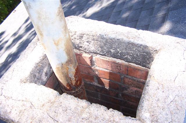

Mark P Posted June 20, 2007 Report Share Posted June 20, 2007 Chimney used only for furnace vent. I usually recommend it be covered, but I guess it has been like this for 80+ years and Iââ¬â¢m now wondering what is the point. Is there any benefit to covering the opening ? I never understood where the rain goes in this type set up, but I see it from time to time. And yes I see the bird nest. Image Insert: 61.27 KB Image Insert: 57.17 KB Quote Link to comment Share on other sites More sharing options...

randynavarro Posted June 20, 2007 Report Share Posted June 20, 2007 Yes, I always recommend caps even thought its old. Water from soaked masonry can wick into the ceiling drywall inside, create musty odors in the basement (if there is one) and all sorts of undesirables. No water in the building envelope. That's my theory and I'm sticking to it!! Quote Link to comment Share on other sites More sharing options...
hausdok Posted June 21, 2007 Report Share Posted June 21, 2007 Well, I'm just down the street from Randy and I don't recommend they put a cap on chimneys. Not because they won't help keep a little bit of water out, but because they just aren't necessary. Probably 95% of the chimneys I look at around here don't have any caps on them and have never had any caps on them. Many of them are pushing 80 - 90 years old and the biggest problem they have is cracked crowns that allow water to permeate the stacks or they're in a serious hurt because they're unlined and someone had been venting either a furnace or water heater through them for decades. The amount of water actually going into the opening of these is very little as far as I can tell. Don't know why - maybe it's because there's always so much heated rusing up through these that a whole lot of evaporation takes place. If people ask me if it's a good idea to add a cap, my response is usually, "It can't hurt," but I don't flog the things. ONE TEAM - ONE FIGHT!!! Mike Quote Link to comment Share on other sites More sharing options...
kurt Posted June 21, 2007 Report Share Posted June 21, 2007 Well, think about it. That opening is approx. 1sf. How much rain actually falls in 1sf? Not much. I think the benefit of the old mortar is missed by most folks. New masonry retains moisture & needs water mgt. systems to deal w/water. Old masonry deals w/moisture by the mass of the masonry; it soaks up a little, then evaporates it back out. Moisture mgt. is accomplished through mass, not flashing, wicks, & weeps. It's part of my unified building theory; I'll get back to y'all when I get it completely figured out. Quote Link to comment Share on other sites More sharing options...
Bill Kibbel Posted June 21, 2007 Report Share Posted June 21, 2007 It needs to be capped, but not because of the rain that might enter. The chimney is now a "cold" chimney since it is no longer venting what it was originally constructed for. There is now a moving cold air current and condensation will rapidly deteriorate the mortar in the joints at the coldest (top) part of the chimney (they're already eroding). Soon, the bricks will begin to spall. If it didn't have a cap in my area, they're would be a pair of glowing eyes in the second picture and the nest occupants would have been a snack. Quote Link to comment Share on other sites More sharing options...
randynavarro Posted June 21, 2007 Report Share Posted June 21, 2007 What about the fireboxes on 40+ year old homes; specifically the rear of the box, where 9 of 10 times I'll see efflorescence and deteriorated mortar. And don't forget rusted dampers. Kurt, remember we're in Seattle. You're right. . . probably not a lot of water down 1 sq. ft. but a little water over an extended period of time adds up. Quote Link to comment Share on other sites More sharing options...

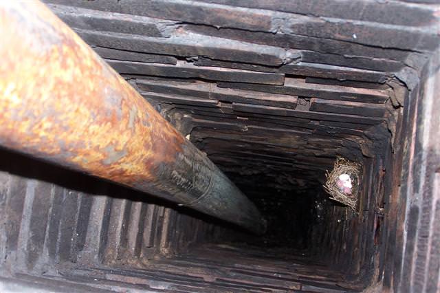

Inspectorjoe Posted September 9, 2007 Report Share Posted September 9, 2007 This one from this morning didn't have a cap. Now that I think about it, it might have had a cap, but it could have fallen in. I wasn't about to get near enough to find out. [:-scared] Image Insert: 143.52 KB Quote Link to comment Share on other sites More sharing options...
bmargiotti Posted November 8, 2007 Report Share Posted November 8, 2007 GREAT picture!! [:-bigeyes i would have fallen off the roof in enjoyment. thats a Chimney Swift nest with eggs and newborns in it. Quote Link to comment Share on other sites More sharing options...
