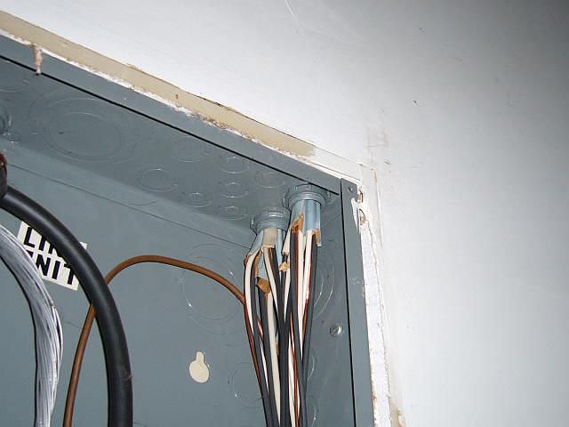

stubrooks Posted September 11, 2007 Report Share Posted September 11, 2007 Has anyone seen something like this? Two sets of SEC are brought in from a single 200 Amp Service meter box connection (1 meter). Each SEC is connected to separate 200 Amp size main panel mounted side by side. Each panel is wired as a Master. I've not seen or heard of this before. A master and a subpanel yes, but not dual masters. Image Insert: 56.23 KB Quote Link to comment Share on other sites More sharing options...

stubrooks Posted September 12, 2007 Author Report Share Posted September 12, 2007 Answers to some questions: 1. The panel covers do cover the exposed bus areas. All breaker slot fillers are in place. I didn't take a picture of the covers. 2. Yes, there are too many wires in a panel entry hole, in several places. 3. Yes, there are unmarked white or neutral wires connected to breakers. 4. More than one ground or neutral inserted into a single bus bar hole - multiple places. There was no need to do so because there are lots of empty connection points. Advised client to have a licensed electrian to review panels and repair wiring. And not to call the same licensed electrician who installed it. It is all too common in this neck of the woods for any ding-a-ling who pulls wire for a week to call himself an electrican and setup shop Image Insert: 101.55 KB Image Insert: 60.5 KB. Quote Link to comment Share on other sites More sharing options...

msteger Posted September 12, 2007 Report Share Posted September 12, 2007 Were these dual panels to feed one home/structure with dual living areas or a storefront and residential space? Since you mention there is only one meter, I would guess it wasn't two separate living areas (like rentals). Not sure why they'd have two panels when each is only partially populated (each appears to be slightly half full). Generally, I'll see one full main panel and then an auxiliary (sub) panel installed feeding off the main panel. If the only service disconnects to be found are the two MAIN's in each panel, then I could considered both of these as 'main panels', but indeed weird, at least in my neck of the woods. Since you are in VA, I would assume they don't put the main service disconnect outside (like they do out west) and then feed the panel(s) on the home's interior. I have seen a few 400 Amp/240 Volt services in my time, but there is normally a large metal distribution box that feeds each panel. I would also recommend evaluation by a licensed electrician as well as determining if the service cable from the street to the meter is capable of supplying these two panels safely. Quote Link to comment Share on other sites More sharing options...

Jim Katen Posted September 13, 2007 Report Share Posted September 13, 2007 Originally posted by AHI Is it ok for the unused portions of those busbars to be exposed like they are? Yes. It's fine. The deadfront is intended to protect them. There's no requirement to have the buses covered with the deadfront off. I see a white hot that looks like it may not be marked. Make that a few unmarked white hots. The white wires are supposed to be marked. A quick swipe from a Sharpie is adequate. Personally, I don't report on this issue. - Jim Katen, Oregon Quote Link to comment Share on other sites More sharing options...
Richard Moore Posted September 13, 2007 Report Share Posted September 13, 2007 "Personally, I don't report on this issue."... Me neither. My feeling is that a white hot wire in a panel is adequately identified by being connected to a (normal) breaker's terminals. In fact I consider it "permanent" identification. Remove the wire and, well, it's no longer hot! Frankly, I can't remember the last time I actually saw a hot white marked at the panel. It sure doesn't seem to be the custom around here. Now...if I saw an unmarked white away from the panel, say in a junction box or as a feed to a sub, that I knew was hot, then different story. THAT, I would consider a reportable safety hazard. Quote Link to comment Share on other sites More sharing options...
charlieb Posted September 13, 2007 Report Share Posted September 13, 2007 The white wires are supposed to be marked. A quick swipe from a Sharpie is adequate. Personally, I don't report on this issue. Jim, Is there not some verbage that states under a specific guage white is not allowed? By the way, I don't write it up as part of a HI. Quote Link to comment Share on other sites More sharing options...
Jim Katen Posted September 13, 2007 Report Share Posted September 13, 2007 Originally posted by charlieb Jim, Is there not some verbage that states under a specific guage white is not allowed? By the way, I don't write it up as part of a HI. Not that I'm aware of. If you're using a cable such as Romex, you can use the white wire as an ungrounded conductor if you re-identify it. If you're pulling wire through conduit, you can't use white wire as an ungrounded conductor at all. You're expected to drag your butt out to the truck and get a reel of properly colored wire. - Jim Katen, Oregon Quote Link to comment Share on other sites More sharing options...
